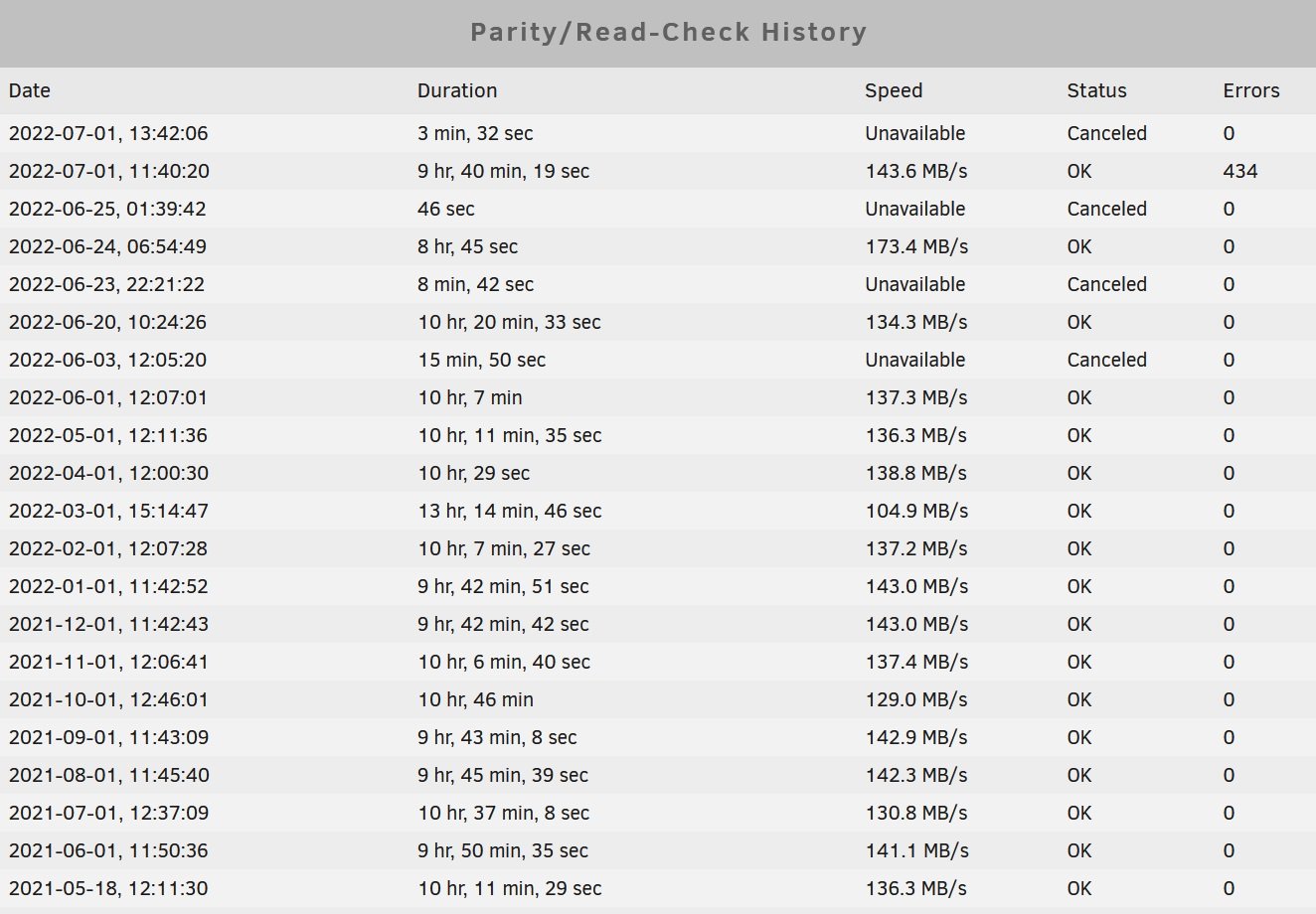

Go to Main - Array Operation, click History, and post a screenshot
Is that the entire History?
Syslog only seemed to be logging P corrections, not Q (parity2), though it didn't log all the corrections. But it does make me wonder if Q was completely valid and P just had those (relatively) few sync errors. Have you had unclean shutdown?

3 hours ago, itimpi said:
Looking at the time it started I assume that was a scheduled check?    We normally recommend that scheduled checks are set to be non-correcting as you do not want a drive that is playing up to corrupt parity.
You didn't specifically comment on this. Was it a scheduled check, and were the scheduled checks set to correct?
It was a scheduled check, here is the full history.
Unrelated, but I fixed the cron for that plugin so that error should stop popping up.
Also, have you changed your scheduled checks to be non-correcting now?
I changed my scheduled checks to be non-correcting.  I had one unclean shutdown on 6/23.
So the parity check which complete without sync errors on 6/24 was after that?
Why the cancelled parity checks in that history?
Correct.  The 6/24 parity check was after the unclean shutdown on 6/23.  There were no parity issues at that point.
The 6/25 parity check was started on accident, meant to hit the mover button. The other check on 7/1 (after the 434 errors) was me thinking about starting another parity check after the issues came up but deciding to wait for more info on the forum before I proceeded.
Do that, make it a non-correcting check. Since you have already corrected parity, it should have zero sync errors this time. Don't reboot, get diagnostics after so we can compare this check with the previous one.
@trurl attached are the updated diagnostics.  Parity check finished with 0 errors.
