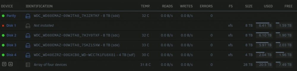

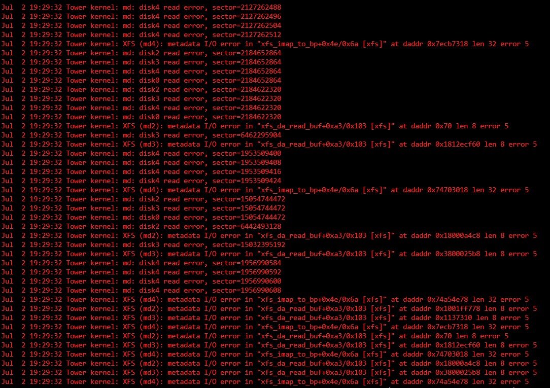

One day ago I shotted down my Unraid to upgrade the GPU and cleaning. Once I put everything back together, now I have problems with my array. At the beginning was showing me that disk 1 had multiple errors, now is missing. I took it out and test it and there was no errors with it when I analyzed. Also I cant stop the array, restart or shut down Unraid.

Solved! GPU and RAID card were not in the same PCI port as I had it before. I guess that messed up something in the configuration. THANKS anyway for your responses.
