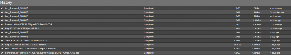

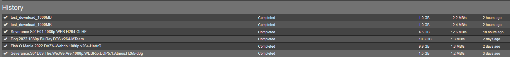

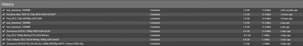

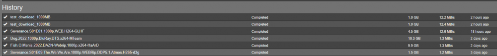

This is me making the change back to the on board sata ports. I'll lets some more downloads occur naturally and will convert back to the HBA card and report back.image.thumb.png.69f000dce9b076e4ea36e078216064e2.png

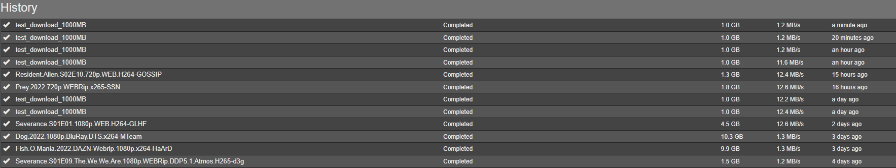

Sab history before switching back to HBA (originally on HBA 3 days and beyond ago).

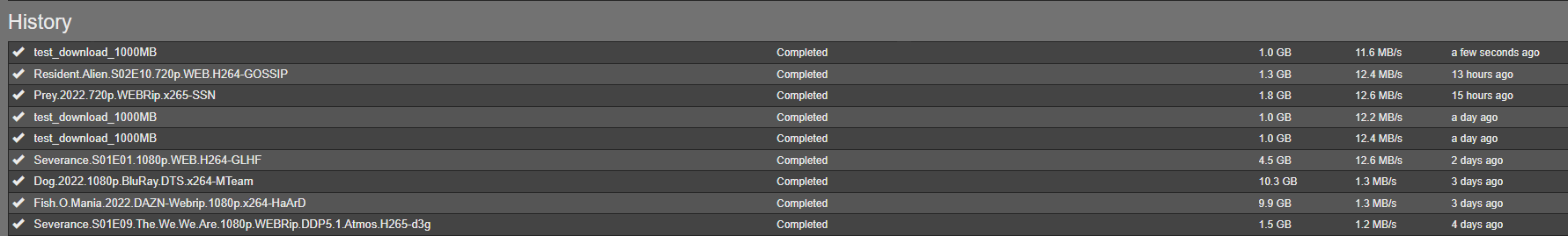

and straight back to throttled downloads :/ this makes no sense haha.
There is no other activey on the server.
Very strange, so docker is only using the NVMe device and just by having the array disks on the LSI without being used by anything you have the low download speed correct?
Correct.
Sometimes there will be a spike in download speed but these are random and also still only around 6MB/s.

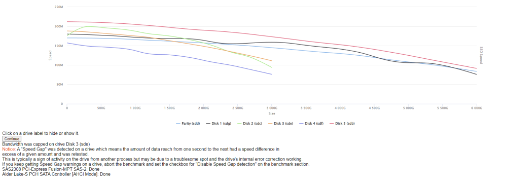

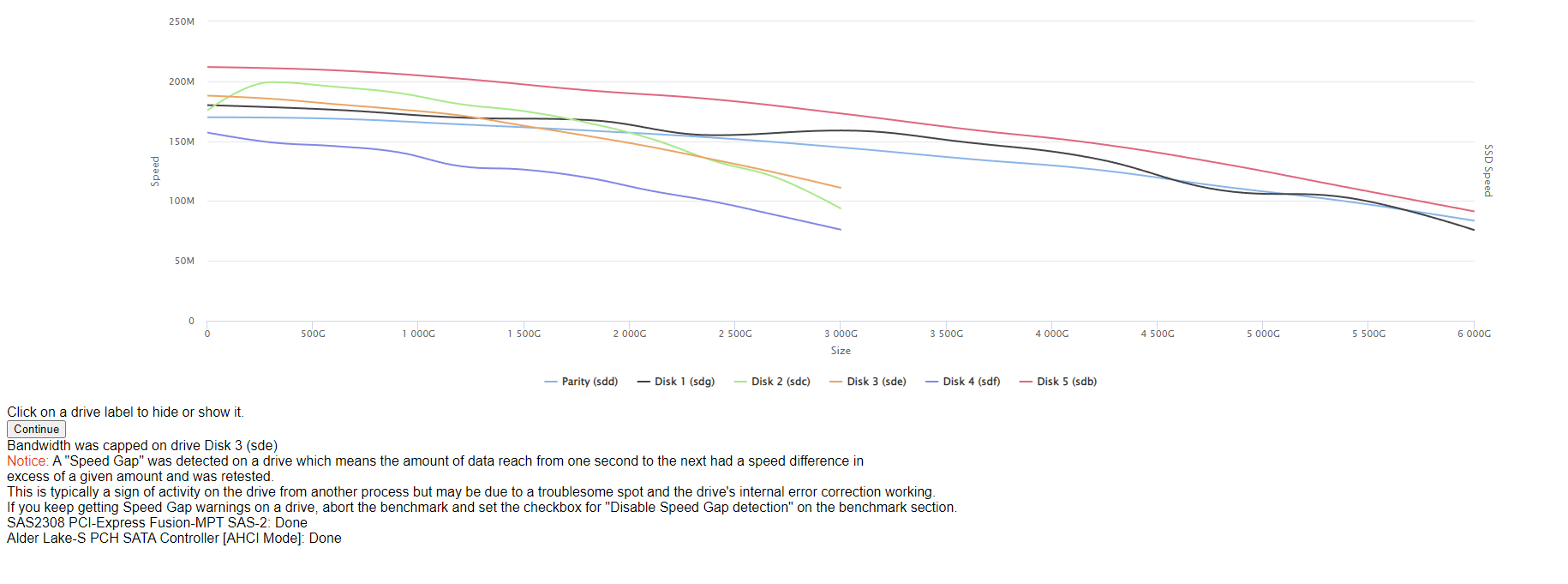

I guess it could, but there's nothing relevant logged, at least for now, though a slow disk would likely not leave a trace, you can run the diskspeed docker to at least see if read performance is normal.
Thanks Jorge,
Not sure what I am looking at to be honest.
That looks normal, though it can only test read speeds, but write speed should be similar.
