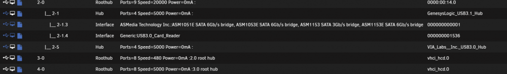

I have 10 external usb hdds connected via a powered usb hub and each of these hdd is powered by a smart plug so I can turn off or on the hdd I need.
I use them little, but I have a problem and a question.
The question is: how do I safely disconnect a usb hdd from unraid? just unmount from Unassigned Devices and turn off the disk?
The problem is: if I unmount a usb hdd and turn it off from the smart plug, when I turn it on again the system does not recognize it until I disconnect the usb socket of the hub and reconnect it to mobo.
Consider that I have used the same hardware on xpenology and have never had any problems with this procedure.
Thank you

This is what I did:
- physically disconnected and reconnect the usb socket of the hub
- turn on via smart plug an hdd that has been correctly detected
- mounted and subsequently unmounted the hdd
- turn off the hdd from the smart plug
- turn on again from the smart plug, the HDD was not recognized
here is the log:

Can you confirm that the device disappears in lsusb?
at what time stamp did you power the drive back on?
Jul 17 00:34:09 here, when i try multiple time to refresh unassigned device
The issue seems to be that the USB connection is not being seen by the host, does it work if you connect to a direct port? Also which vers of unraid are you running?
Not sure why the host is not seeing the port come back.

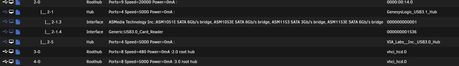

This is my system with device connected via hub, not powered as I dont have one and removing the external power and adding back in. ASMedia is my USB to SATA port.
Jul 17 10:25:59 computenode zed[6877]: zed_udev_monitor: skip /dev/sdc since it has a dos partition already
Jul 17 10:25:59 computenode usb_manager: Info: rc.usb_manager usb_remove  ASMT_ASM1153E_000000000001 /dev/bus/usb/002/011 002 011
Jul 17 10:25:59 computenode usb_manager: Info: rc.usb_manager Device Match 002/011 vm:   002 011
Jul 17 10:25:59 computenode usb_manager: Info: rc.usb_manager Removed 002/011 vm:  nostate 002 011
Jul 17 10:26:11 computenode kernel: usb 2-1.3: new SuperSpeed USB device number 12 using xhci_hcd
Jul 17 10:26:11 computenode kernel: usb-storage 2-1.3:1.0: USB Mass Storage device detected
Jul 17 10:26:11 computenode kernel: usb-storage 2-1.3:1.0: Quirks match for vid 174c pid 55aa: 400000
Jul 17 10:26:11 computenode kernel: scsi host1: usb-storage 2-1.3:1.0
Jul 17 10:26:11 computenode usb_manager: Info: rc.usb_manager usb_add ASMT_ASM1153E_000000000001 /dev/bus/usb/002/012 002 012
Jul 17 10:26:11 computenode usb_manager: Info: rc.usb_manager Autoconnect Parent 2-1
Jul 17 10:26:11 computenode usb_manager: Info: rc.usb_manager Autoconnect No Mapping found ASMT_ASM1153E_000000000001 /dev/bus/usb/002/012 002 012 port 2-1.3
Jul 17 10:26:12 computenode kernel: scsi 1:0:0:0: Direct-Access     ASMT     2115             0    PQ: 0 ANSI: 6
Jul 17 10:26:12 computenode kernel: sd 1:0:0:0: Attached scsi generic sg2 type 0
Jul 17 10:26:12 computenode kernel: sd 1:0:0:0: [sdc] Spinning up disk...
Jul 17 10:26:17 computenode kernel: .....ready
Jul 17 10:26:17 computenode kernel: sd 1:0:0:0: [sdc] 625142448 512-byte logical blocks: (320 GB/298 GiB)
Jul 17 10:26:17 computenode kernel: sd 1:0:0:0: [sdc] Write Protect is off
Jul 17 10:26:17 computenode kernel: sd 1:0:0:0: [sdc] Mode Sense: 43 00 00 00
Jul 17 10:26:17 computenode kernel: sd 1:0:0:0: [sdc] Write cache: enabled, read cache: enabled, doesn't support DPO or FUA
Jul 17 10:26:17 computenode kernel: sdc: sdc1
Jul 17 10:26:19 computenode emhttpd: spinning down /dev/sda
Jul 17 10:26:22 computenode kernel: sd 1:0:0:0: [sdc] Attached SCSI disk
Jul 17 10:26:23 computenode zed[6877]: zed_udev_monitor: skip /dev/sdc since it has a dos partition already
Jul 17 10:26:23 computenode unassigned.devices: Disk with ID 'ST3320310CS_9TX0L0HF (sdc)' is not set to auto mount.
Jul 17 10:26:23 computenode zed[6877]: zed_udev_monitor: skip /dev/sdc1 (in use by btrfs)
Jul 17 10:26:36 computenode emhttpd: spinning down /dev/sde
Jul 17 10:26:54 computenode emhttpd: spinning down /dev/sdg
Jul 17 10:26:56 computenode kernel: usb 2-1.3: USB disconnect, device number 12
Jul 17 10:26:56 computenode zed[6877]: zed_udev_monitor: skip /dev/sdc1 (in use by btrfs)
Jul 17 10:26:56 computenode kernel: sd 1:0:0:0: [sdc] Synchronizing SCSI cache
Jul 17 10:26:56 computenode kernel: sd 1:0:0:0: [sdc] Synchronize Cache(10) failed: Result: hostbyte=0x01 driverbyte=DRIVER_OK
Jul 17 10:26:57 computenode zed[6877]: zed_udev_monitor: skip /dev/sdc since it has a dos partition already
Jul 17 10:26:57 computenode usb_manager: Info: rc.usb_manager usb_remove  ASMT_ASM1153E_000000000001 /dev/bus/usb/002/012 002 012
Jul 17 10:26:57 computenode usb_manager: Info: rc.usb_manager Device Match 002/012 vm:   002 012
Jul 17 10:26:57 computenode usb_manager: Info: rc.usb_manager Removed 002/012 vm:  nostate 002 012
Jul 17 10:27:11 computenode kernel: usb 2-1.3: new SuperSpeed USB device number 13 using xhci_hcd
Jul 17 10:27:11 computenode kernel: usb-storage 2-1.3:1.0: USB Mass Storage device detected
Jul 17 10:27:11 computenode kernel: usb-storage 2-1.3:1.0: Quirks match for vid 174c pid 55aa: 400000
Jul 17 10:27:11 computenode kernel: scsi host1: usb-storage 2-1.3:1.0
Jul 17 10:27:11 computenode usb_manager: Info: rc.usb_manager usb_add ASMT_ASM1153E_000000000001 /dev/bus/usb/002/013 002 013
Jul 17 10:27:11 computenode usb_manager: Info: rc.usb_manager Autoconnect Parent 2-1
Jul 17 10:27:11 computenode usb_manager: Info: rc.usb_manager Autoconnect No Mapping found ASMT_ASM1153E_000000000001 /dev/bus/usb/002/013 002 013 port 2-1.3
Jul 17 10:27:12 computenode kernel: scsi 1:0:0:0: Direct-Access     ASMT     2115             0    PQ: 0 ANSI: 6
Jul 17 10:27:12 computenode kernel: scsi 1:0:0:0: Attached scsi generic sg2 type 0
Jul 17 10:27:12 computenode kernel: sd 1:0:0:0: [sdc] Spinning up disk...
Jul 17 10:27:24 computenode kernel: ............ready
Jul 17 10:27:24 computenode kernel: sd 1:0:0:0: [sdc] 2930277168 512-byte logical blocks: (1.50 TB/1.36 TiB)
Jul 17 10:27:24 computenode kernel: sd 1:0:0:0: [sdc] 4096-byte physical blocks
Jul 17 10:27:24 computenode kernel: sd 1:0:0:0: [sdc] Write Protect is off
Jul 17 10:27:24 computenode kernel: sd 1:0:0:0: [sdc] Mode Sense: 43 00 00 00
Jul 17 10:27:24 computenode kernel: sd 1:0:0:0: [sdc] Write cache: enabled, read cache: enabled, doesn't support DPO or FUA
Jul 17 10:27:24 computenode kernel: sdc: sdc1 sdc2 sdc3 sdc4
Jul 17 10:27:24 computenode kernel: sd 1:0:0:0: [sdc] Attached SCSI disk
Jul 17 10:27:26 computenode zed[6877]: zed_udev_monitor: skip /dev/sdc since it has a dos partition already
Jul 17 10:27:26 computenode unassigned.devices: Disk with ID 'WDC_WD15EARS-60MVWB0_WD-WCAZA8204270 (sdc)' is not set to auto mount.
Jul 17 10:27:26 computenode zed[6877]: zed_udev_monitor: skip /dev/sdc3 (in use by ntfs)
Jul 17 10:27:27 computenode unassigned.devices: Disk with ID 'WDC_WD15EARS-60MVWB0_WD-WCAZA8204270 (sdc)' is not set to auto mount.
Jul 17 10:27:27 computenode zed[6877]: zed_udev_monitor: skip /dev/sdc1 (in use by ntfs)
Jul 17 10:27:27 computenode zed[6877]: zed_udev_monitor: skip /dev/sdc4 (in use by ntfs)
Jul 17 10:27:27 computenode zed[6877]: zed_udev_monitor: skip /dev/sdc2 (in use by ntfs)
