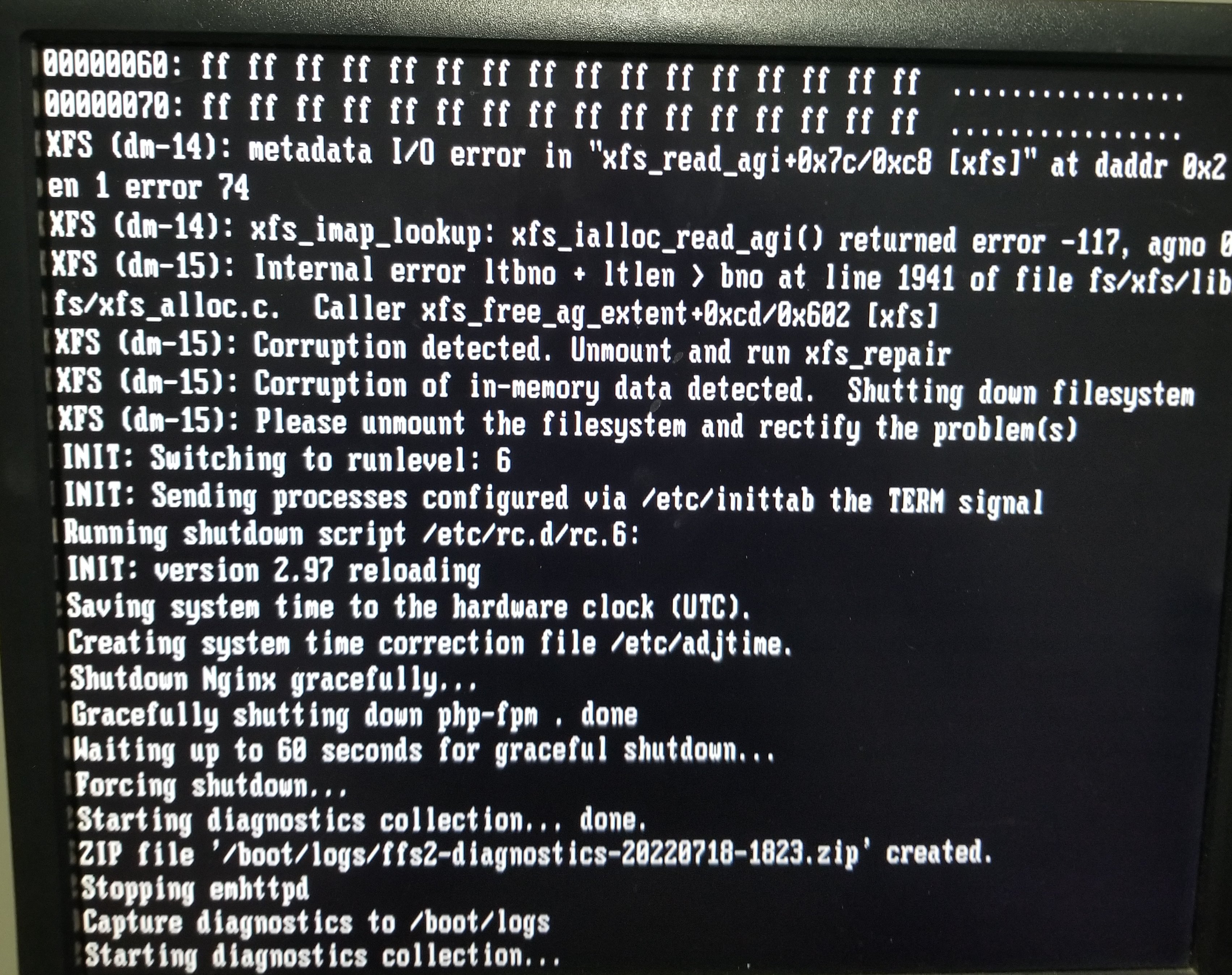

Saw this on the console as I was taking the server down for a reboot.  What does this mean?
According to syslog disk16 (dm-15) was unmountable then you formatted it. Was it supposed to have data? Or was it a new disk that hadn't been formatted yet?
Your screenshot also showed disk15 (dm-14) in a similar state, it is mounted now but has little if any data.
Both were new.  Disk16 was installed parity rebuilt and never showed as needing formatted... Then it unmounted during a parity check and remained that way.  I formatted it and I'm sure I lost some data..... The next disk added showed unformatted from the get-go and thus was formatted and then parity rebuilt.
I'm about to scrap this entire server and start over.  Just finished a parity check after rebuilding that damn drive and my error count is 1285349.
