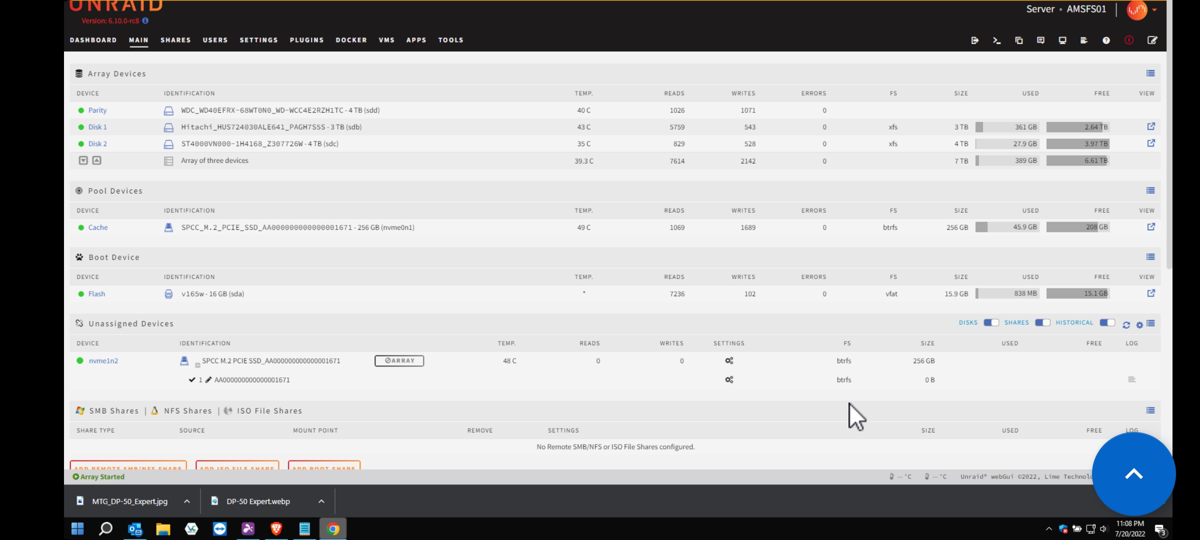

Post a screenshot of Main - Pool Devices
and a screenshot of Main - Unassigned Devices

diagnostics smart folder shows nvme0n1 no longer connected but nvme1n2 is. These appear to the the same device. Or are there actually 2 nvme drives?
Must have disconnected then reconnected. But screenshot shows cache still mounted and with contents, and df in diagnostics agrees with that.
btrfs-usage in diagnostics seems off though, and syslog has entries that look like cache corruption which is why I asked about memtest.
Memory wouldn't be the reason for the disconnection though so maybe the cache corruption logged is really just a symptom of disconnected cache.
How is this drive connected? Does it have plenty of cooling?
