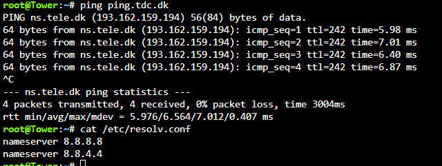

I run a setup with 2 pihole servers as my primary and secondary DNS servers. Since I figured this might be caused by my pihole instances blocking something I have set googles DNS servers as both primary and secondary DNS servers for my unraid server.
I can ping external websites by URL, so name resolution is working, but updating is still not working.
Your name resolution isn't working properly for some reason.
I can almost guarantee you can't ping github.com
While google's DNS servers are great, I'd try using OpenDNS instead 208.67.222.222 / 208.67.220.220
I tried pinging github.com and that worked without a problem
I tried to change the DNS servers to OpenDNS, as you suggest, and even rebooted my server again, but it still doesn't work =\
