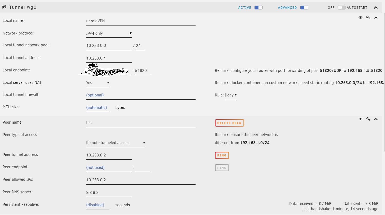

So to achieve the above goals I selected "Peer type of access: remote access to LAN" in the Unraid Wireguard config.
That way I achieved goals 1 ,2, and 3.

Are you trying to ssh to the name of the server on your local LAN, or using the ip address assigned to the tunnel?   Reason I am asking is that if doing the former and both client and server are on the same ip subnet (i.e. 192.168.0.?) then you may have a name resolution issue.  I deliberately avoid using a subnet of the form 192.168.0.X or 192.168.1.X for my local LAN as a remote client is often on a subnet with that address range.   Perhaps a screenshot of the WireGuard settings on Unraid for the tunnel you are using and the command you are trying to use to ssh would help clarify?

The following happens with "remote tunneled access" as well as "remote access to LAN"

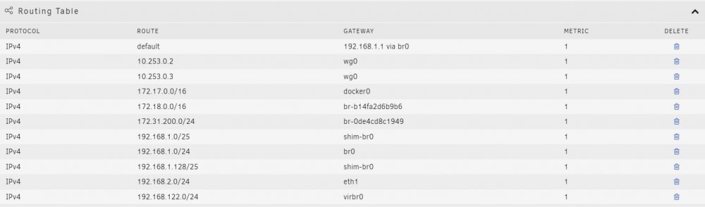

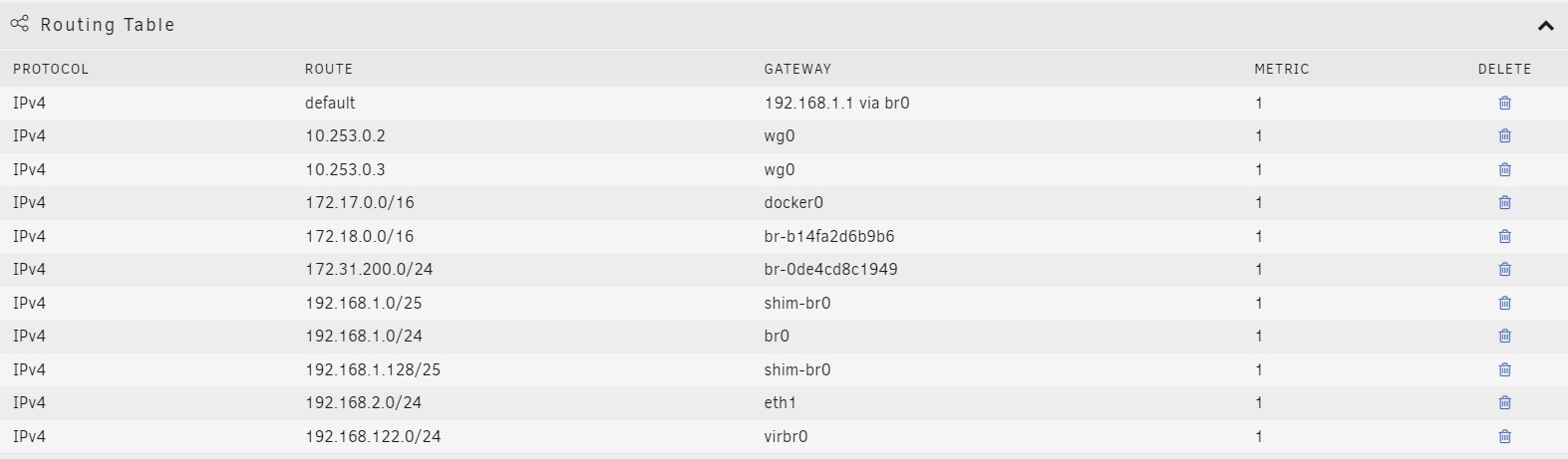

blow are my routing tables.
I have no idea where these came from or what they are used for:
  • br-b14fa2d6b9b6
  • br-b14fa2d6b9b6
  • shim-br0
  • virbr0
