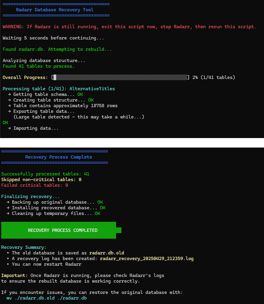

April 29, 20251 yr I recently encountered the same issue with a malformed database disk image in Radarr. After some trial and error, I built upon a script originally posted by rhinot (Special thanks to rhinot for the original script) that is able to repair the Radarr DB. I've shared this script in my GitHub repository, and I hope it can help others facing the same problem. https://github.com/itmunky/ScriptStash/tree/main/Radarr#description Script: https://github.com/itmunky/ScriptStash/blob/main/Radarr/improved_radarr_recovery.sh
May 13, 20251 yr On 4/29/2025 at 2:53 PM, Stampy said: I recently encountered the same issue with a malformed database disk image in Radarr. After some trial and error, I built upon a script originally posted by rhinot (Special thanks to rhinot for the original script) that is able to repair the Radarr DB. I've shared this script in my GitHub repository, and I hope it can help others facing the same problem. https://github.com/itmunky/ScriptStash/tree/main/Radarr#description Script: https://github.com/itmunky/ScriptStash/blob/main/Radarr/improved_radarr_recovery.sh This worked great.
May 15, 20251 yr On 4/29/2025 at 12:53 PM, Stampy said: I recently encountered the same issue with a malformed database disk image in Radarr. After some trial and error, I built upon a script originally posted by rhinot (Special thanks to rhinot for the original script) that is able to repair the Radarr DB. I've shared this script in my GitHub repository, and I hope it can help others facing the same problem. https://github.com/itmunky/ScriptStash/tree/main/Radarr#description Script: https://github.com/itmunky/ScriptStash/blob/main/Radarr/improved_radarr_recovery.sh This script from @Stampy worked perfectly! I tried the simple .recover command suggested around and it didn't fix my db errors but this script did! 10/10 would recommend

July 27, 20251 yr On 4/29/2025 at 7:53 PM, Stampy said:I recently encountered the same issue with a malformed database disk image in Radarr. After some trial and error, I built upon a script originally posted by rhinot (Special thanks to rhinot for the original script) that is able to repair the Radarr DB. I've shared this script in my GitHub repository, and I hope it can help others facing the same problem. https://github.com/itmunky/ScriptStash/tree/main/Radarr#descriptionScript: https://github.com/itmunky/ScriptStash/blob/main/Radarr/improved_radarr_recovery.shThis worked perfectly for me, thank you! I had noticed that Radarr's Acitvity > History wasn't updating with new events following a restore I made last week. Found the logging containing 'Database disk image is malformed' and found my way here after about 10 minutes of searching. Your script worked first time - my existing history is there still and new events are being added as you'd hope. I'm on Unraid 6.12.13 in case anybody happens to care when finding this post later on
October 4, 2025Oct 4 On 4/29/2025 at 7:53 PM, Stampy said:I recently encountered the same issue with a malformed database disk image in Radarr. After some trial and error, I built upon a script originally posted by rhinot (Special thanks to rhinot for the original script) that is able to repair the Radarr DB. I've shared this script in my GitHub repository, and I hope it can help others facing the same problem. https://github.com/itmunky/ScriptStash/tree/main/Radarr#descriptionScript: https://github.com/itmunky/ScriptStash/blob/main/Radarr/improved_radarr_recovery.shTried running this not sure if im doing it correctly, it outputs the following.Found radarr.db. Attempting to rebuild...Analyzing database structure...Empty database. Unable to restore.
