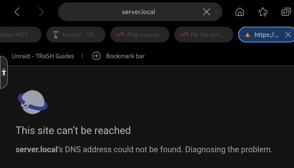

August 5, 20224 yr Hi, I wasn't able to use port forwarding so I could access my server from outside my local network. I contacted my ISP and my network is now connected using IPv6 which they said will resolve the issue. So after changing my router, I went into the servers settings and selected IPv6 only in the Network settings. Now I can't access the server on my local network. Nothing else was changed in my routers settings, so I don't understand why I can't access the server using the IP address that I reserved for it. I'm actually feeling pretty stupid.... Can someone spare a moment to help? Thanks heaps Edited August 5, 20224 yr by HomerJ Screenshot upload
August 5, 20224 yr Author BTW, I've checked the router to see what devices are connected, and I can't find the server at all.
August 5, 20224 yr Author Solution Update- I've been able to get into the server, albeit only in safe GUI mode for some reason, and I've changed its network credentials back to IPv4 only again, and I'm again able to find the server on my network. I'll mark this as resolved, but if anyone has any good advice or links to good guides which help transition from IPv4 to IPv6, please let me know. Cheers!
