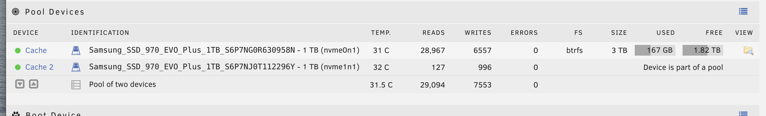

How does this match to this view?

1770136599_Bildschirmfoto2022-08-07um10_25_38.thumb.png.656ba027cd01457be8d5f31772839615.png
The GUI won't show device errors for pool members, see here for more info and better pool monitoring.

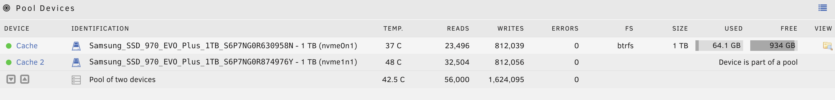

It seems both of the ssd have bad blocks or something. I got some 2 new SSDs. In the first step i changed nvme1n1 with a new one. I formatted the new one and added it to the cache pool
471270422_Bildschirmfoto2022-11-10um20_26_54.thumb.png.688cf53a8fd1b71f2a96beb879549a1f.png
My thoughts: After some time the cache is in sync and I can remove nvme0n1 with a new one. But when I started the system all my dockers and stuff was gone. BRTFS was not up and running and told me to many device changes or something..
Then I plugged in the old one and started my containers and stuff - everything fine.
How can I check that both nvme ssd are in sync to change the last one? Am I missing any important steps?
No need to format.
Would need the diags after the the replacement attempt to see what's going on.
Cache1 is also failing, best to backup and re-format the pool with both new devices.
I know, that's the reason why I wanted to change both - but I am failing with replacing the first one. Just copying all data to my array? Are there any necessary important steps to consider..?
Stop VM and docker services and copy everything you can to the array or elsewhere.
I'll do this.
