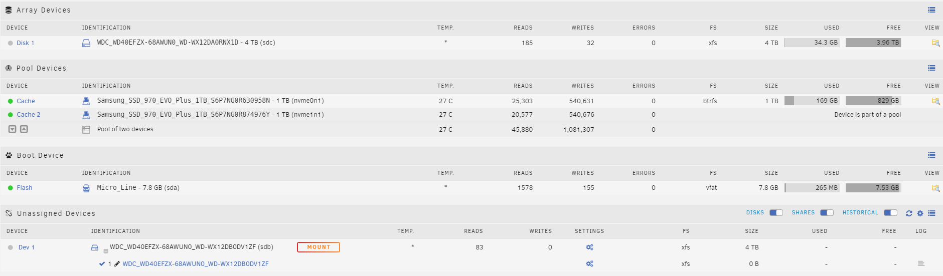

  5. I was not able to add the nee Disc to the cache pool without formatting it. Added the diagnostics. BR Mansoor jarvis-diagnostics-20221114-2254.zip
  6. It seems both of the ssd have bad blocks or something. I got some 2 new SSDs. In the first step i changed nvme1n1 with a new one. I formatted the new one and added it to the cache pool My thoughts: After some time the cache is in sync and I can remove nvme0n1 with a new one. But when I started the system all my dockers and stuff was gone. BRTFS was not up and running and told me to many device changes or something.. Then I plugged in the old one and started my containers and stuff - everything fine. How can I check that both nvme ssd are in sync to change the last one? Am I missing any important steps? BR

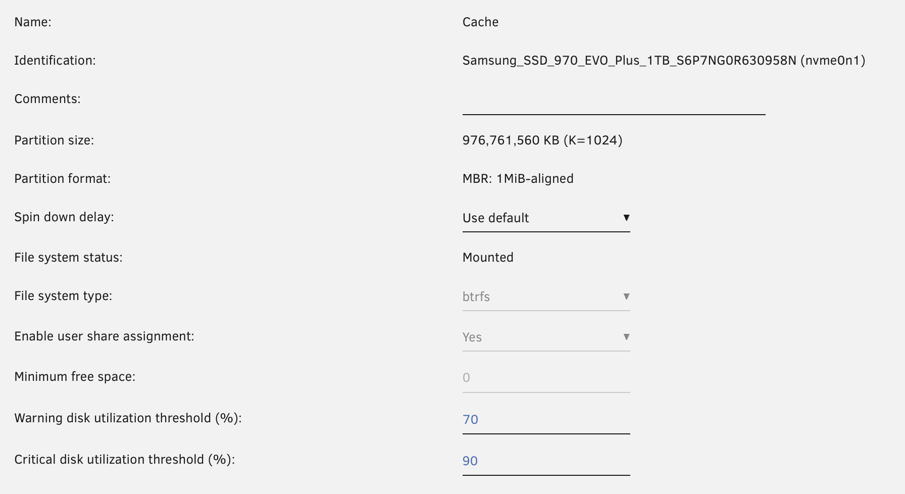

  7. How does this match to this view? I was able to get my dockers on this ssds up and running again. I think I've to change nvme1. Can I just unplug this after shutdown and cache is up an running just with 1 ssd - right? My VM is not able to start "bad system config" any repair option are not working and chkdsk /f is failing because auf "device in read only". Can you give me some support how to proceed correctly to get everything up an running in the correct way / process? Sorry - the first time I am hitting any issue with my unraid system. That means I am a noob in troubleshooting anything ^^ BR

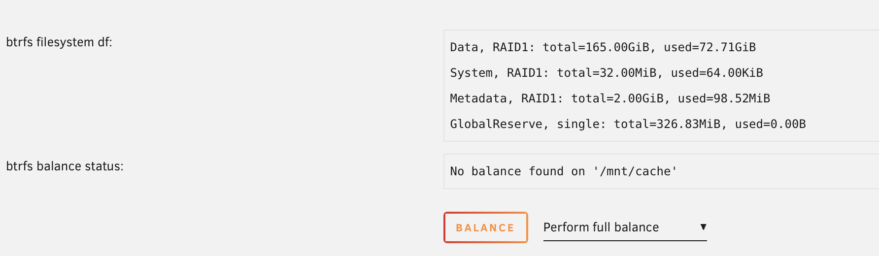

  11. Okay gelesen, Danke! D.h. für mich es ist alles in Ordnung da in allen Zeile Raid1 steht. Balance zu drücken / covert to Raid1 ist nicht nötig - richtig?
  12. Also ganz eindeutig ist mir das noch nicht, hier steht zwar etwas von brtfs und auch von Raid1, ich kann das aber auch in einen Raid0 oder Raid1 konvertieren in den Optionen. Außerdem steht bei brtfs Balance Status: No Balance found .. Sorry für die noobigen Fragen 😄

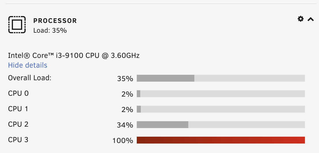

  15. Habe eben das unassaigned devices Plugin installiert und den Krusader und kopiere mal testweise ein paar Files via smb, dabei ist mir folgendes aufgefallen Scheint mir nicht ganz normal es läuft momentan nichts außer das Grundsystem und Krusader .. 3109 66.6 0.1 1334100 19968 ? Rl 21:05 88:58 /usr/sbin/libvirtd -d -l -f /etc/libvirt/libvirtd.conf -p /var/run/libvirt/libvirtd.pid

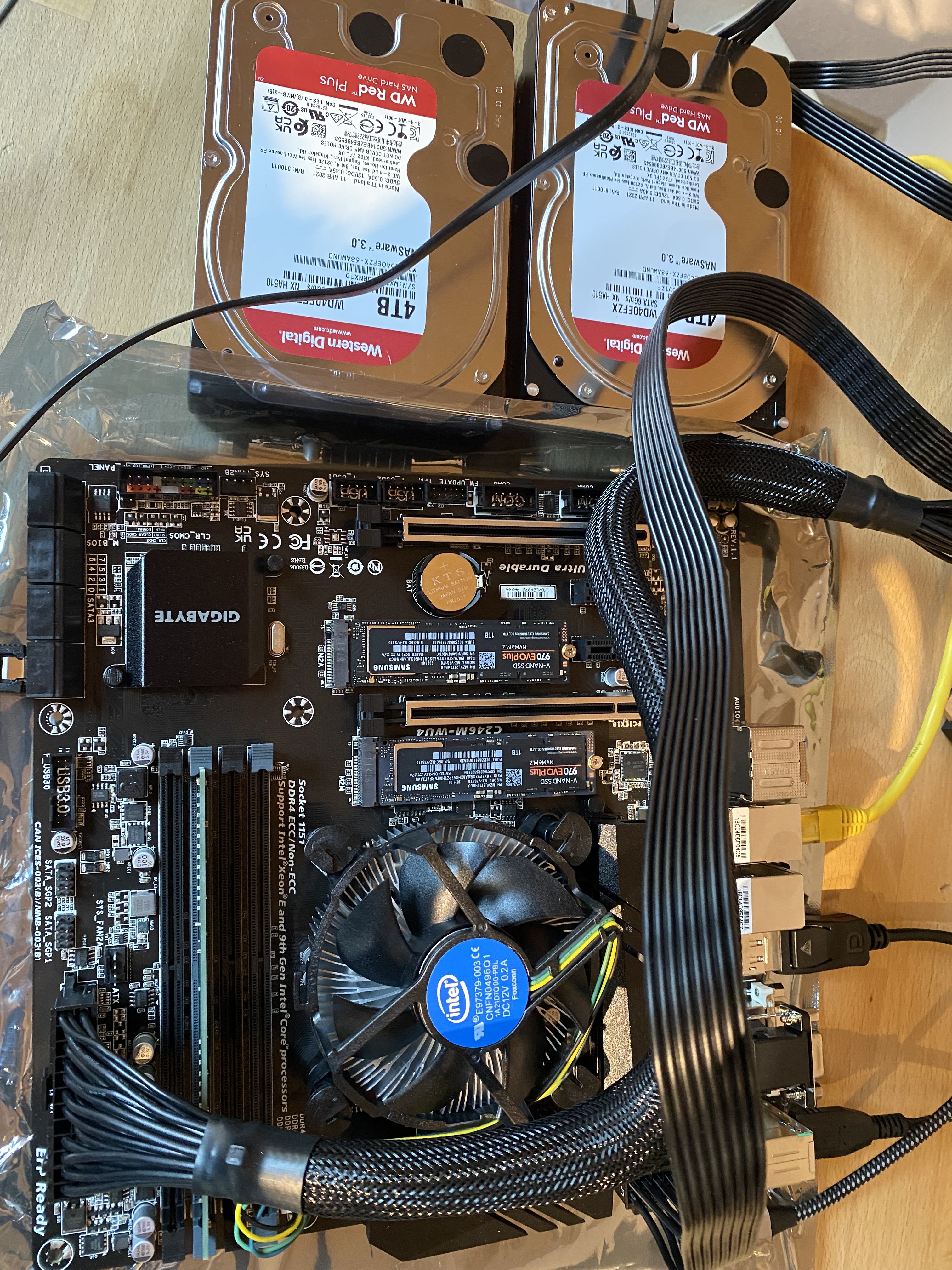

  16. So die Hardware ist gekommen und ich konnte ein 246M-WU4 ergattern. Das initiale Setup inkl einer WIN10 VM und hat schon mal geklappt. I @mgutt Ist mit diesem Bosrd ein vergleichbarer Stromverbrauch zu realisieren wie mit der mITX Variante? Wärst du so nett und würdest mir sagen was ich dazu im BIOS einstellen muss? Habe deinen Artikel zur Messung gelesen, bin mir aber noch unsicher was nun die richtigen Einstellungen sind.
