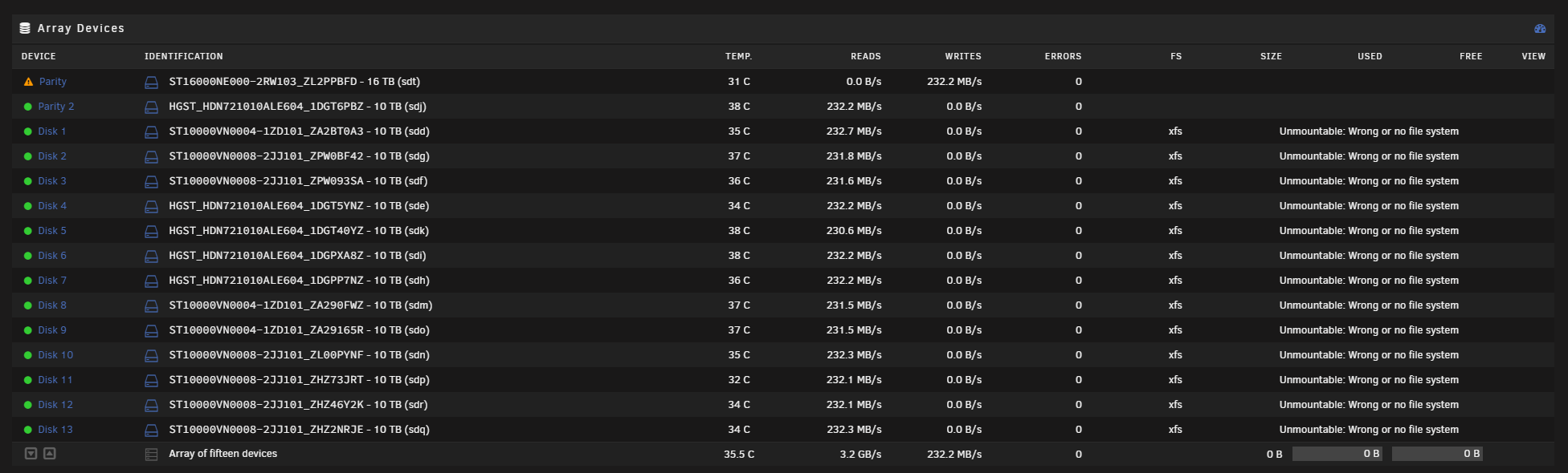

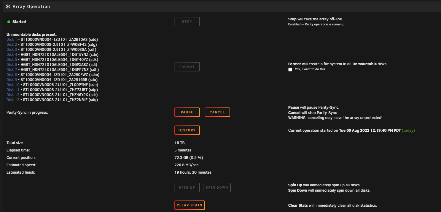

August 9, 20224 yr Maybe I screwed up this process but here is what I did.... I have 2 parity drives (10tb each) and wanted to upgrade them to 16tb drives. I figured the best process was to do this one drive at a time and let each re-build. - I stopped the array from the GUI - physically removed Parity drive 1 (10tb) - physically replaced with a new 16tb drive - selected the new 16tb drive in the gui for Parity Drive - started the array and now all my other disks give me the Unmountable: Wrong or no file system error I'm trying to remain calm but definitely feel the nerves kicking in lol. Can anyone please point me in the right direction to not completely screw up my entire server haha. Please and thank you 🙂 Edited August 9, 20224 yr by fattrain
August 9, 20224 yr Author Thanks a ton in advance for your help! Diagnostics Zip File Attached! tower-diagnostics-20220809-1442.zip
August 9, 20224 yr Community Expert That looks OK. Of course, simply replacing parity will not have changed anything about the other disks so I don't know what's going on. And your cache did mount. There are call traces in syslog when it tries to mount each disk, maybe controller or power problem? Shutdown and check all connections I guess, maybe reseat controllers.
August 9, 20224 yr Author I mean I changed literally nothing other than removing the drive and replacing it with another drive and it's a in a pretty solid rack mount setup.... I will stop the parity rebuild and give the machine a fresh reboot and see if the problem persists Was my procedure otherwise correct for replacing / upgrading my parity drive from a 10tb to 16tb ? Edited August 9, 20224 yr by fattrain

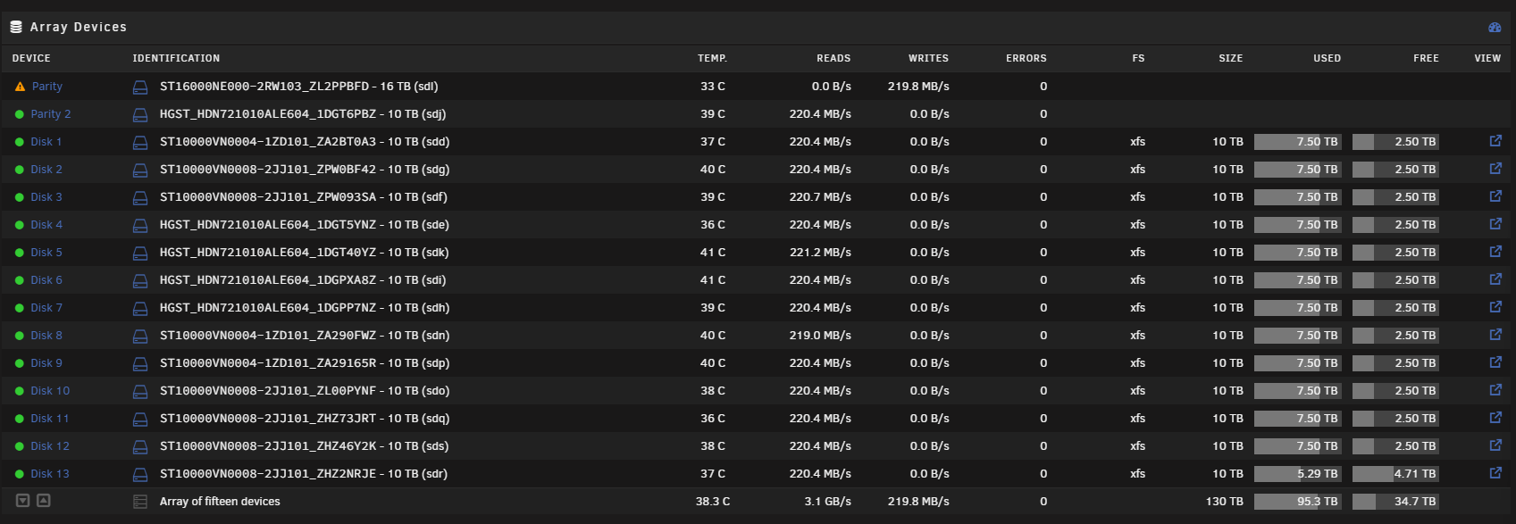

August 9, 20224 yr Author Welp, I guess you weren't kidding lol I shutdown the entire system, booted it back up a few minutes later and we're good I think

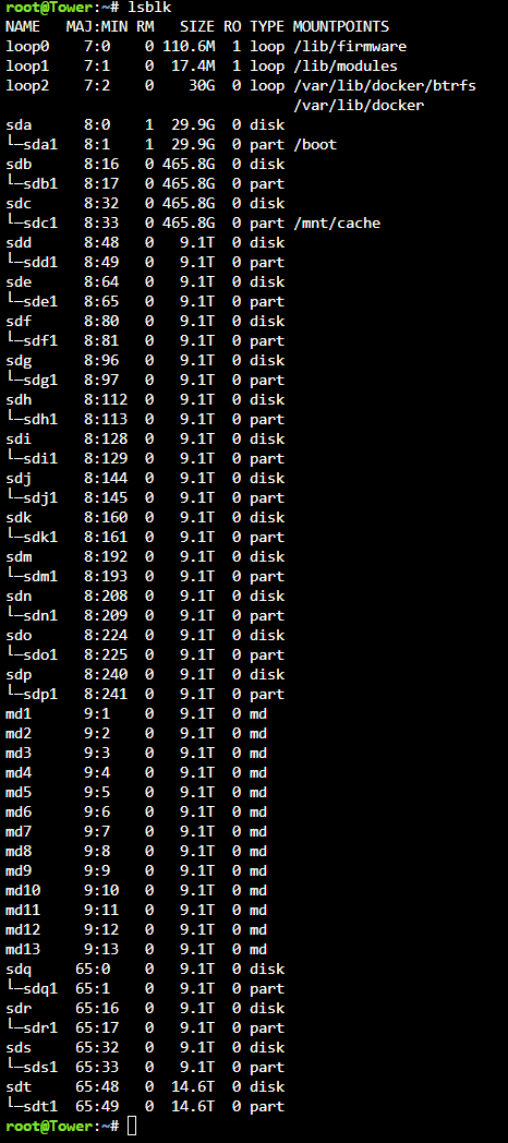

August 9, 20224 yr Community Expert 10 minutes ago, fattrain said: Welllllll not quite solved.... All my docker containers are missing now 😞 Any idea there? Makes me wonder if cache mounted this time. Post new diagnostics
August 9, 20224 yr Author Just now, trurl said: Makes me wonder if cache mounted this time. Post new diagnostics tower-diagnostics-20220809-1614.zip
August 9, 20224 yr Community Expert Your system share has files on cache and disk1, must have created a new docker.img on either cache or disk1. Of course, you want it on cache, can't tell if it was on disk1 before since disk1 didn't mount. New docker.img would make you have to install all your containers again but no harm in that if you reuse the templates since appdata is still there.
