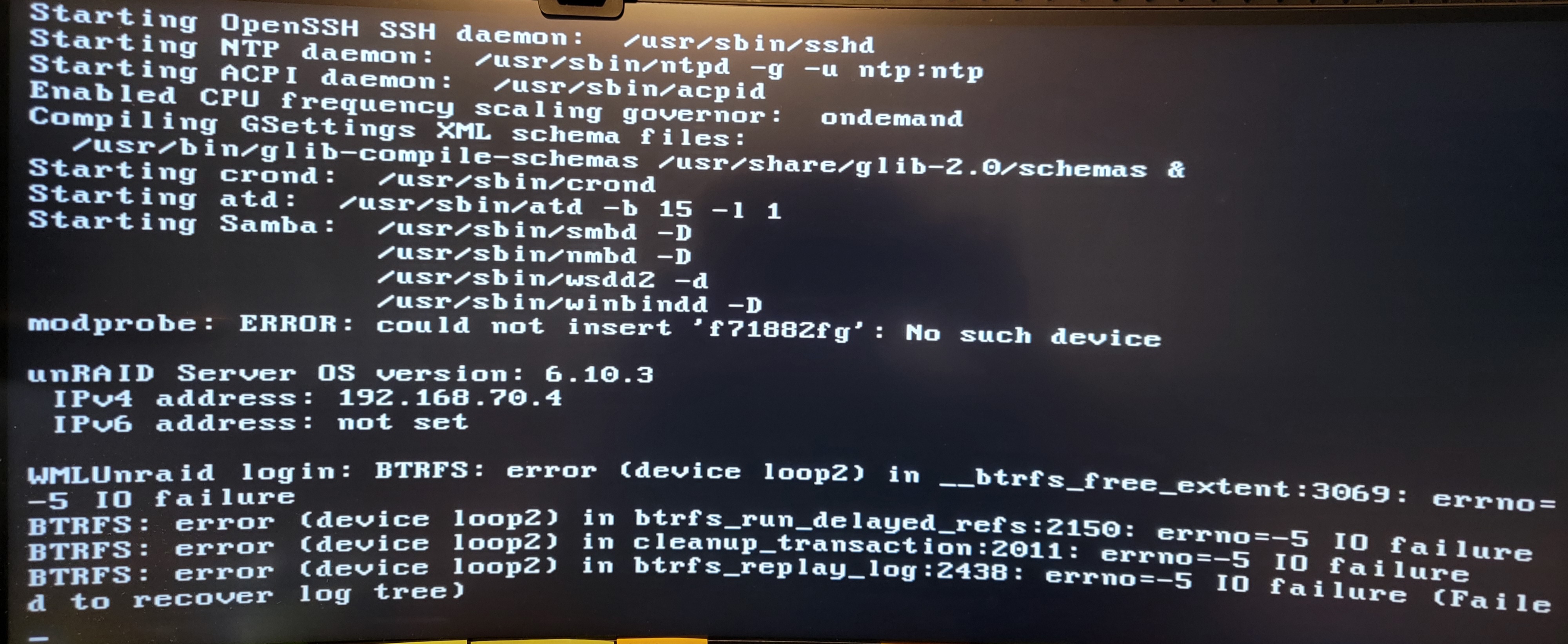

August 11, 20224 yr Author On the server, I'm seeing these disk errors. See the attached picture. Quick search on these forums look like it's an issue with the Docker image or the cache disk full. I think the docker image is at the max 40GB but the cache disk is not full. But it does correlate to the issue of the cache disk dropping out like JorgeB said.
August 11, 20224 yr Community Expert Can't tell anything about that since the array was not started in those diagnostics so nothing was mounted. Start array and attach new diagnostics to your NEXT post in this thread.

August 11, 20224 yr Community Expert 2 minutes ago, soysauce10 said: I just swapped out the sata cable to troubleshoot. Before or after these last diags? It's still dropping. Also the docker image is corrupt and needs to be re-created.
August 11, 20224 yr Author 1 minute ago, JorgeB said: Before or after these last diags? It's still dropping. Also the docker image is corrupt and needs to be re-created. I swapped the cable before exporting the diags. Yeah, I can still see the errors on the server. Does recreating the image mean losing all settings on the containers? Is there a way to restore?
