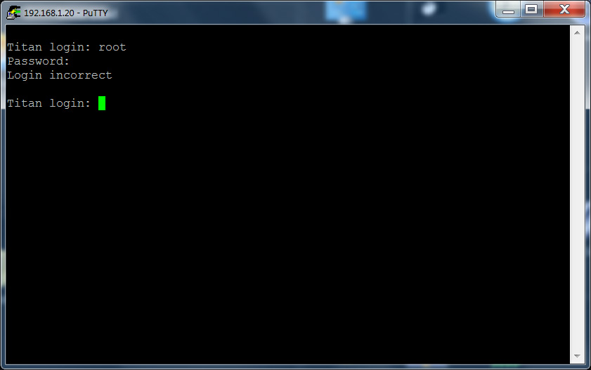

Hello.  I'm running unRAID version 4.7 and I do not have a password assigned to the root user account.  I use putty almost daily to connect to my unRAID server to manage media files using the MC utility.  99-percent of the time I can connect as root with no issue whatsoever.  But every now and then when I try to log in as "root" it prompts for a password.
Here's a snippet from the syslog:
Jun 8 13:31:36 Titan in.telnetd[12288]: connect from 192.168.1.101 (192.168.1.101)
Jun 8 13:31:38 Titan login[12289]: ILLEGAL ROOT LOGIN on `pts/8' from `192.168.1.101'
I never assigned a password to the root user account so I'm not sure why this is happening.
I can get around this root password prompt by stopping the array and rebooting.  Once I do that, I can once again login as root without a password.  But then the same issue will happen again, usually in a few weeks.
I'm the only one who logs into this server so I know nobody is changing the password or messing with config. files.
Does anyone know why this is happening?
Thanks!

I use:  "telnet <ip-address-of-unraid-server>"  or  "telnet 192.168.1.20"
I tried hitting <enter> at the password prompt whenever this happens but it still refuses access.  When I reboot the unRAID server I can then connect with "telnet 192.168.1.20" and it lets me in without a password.
This process repeats itself every few weeks for no reason that I could find thus far.

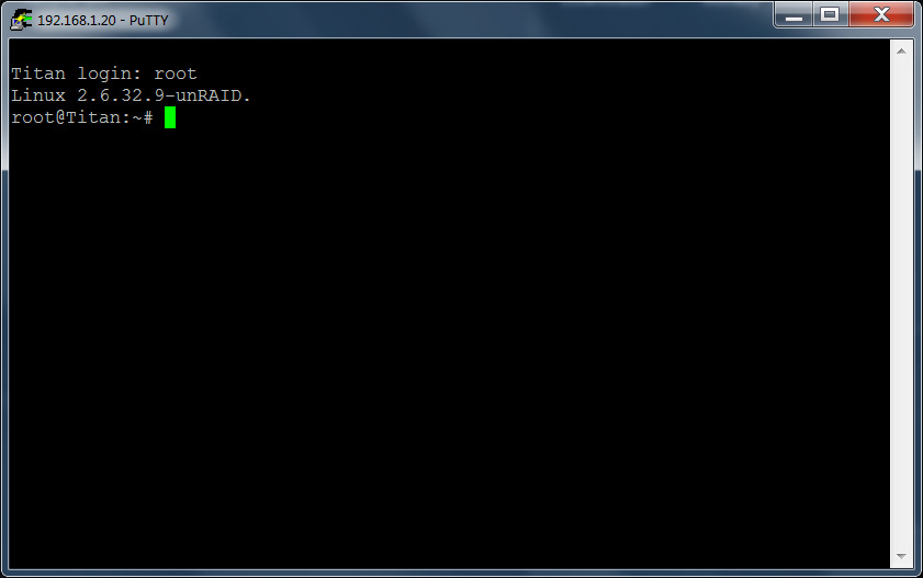

The root password prompt started happening again today so I was able to capture the syslog and some screen shots.
Any help would be much appreciated.
