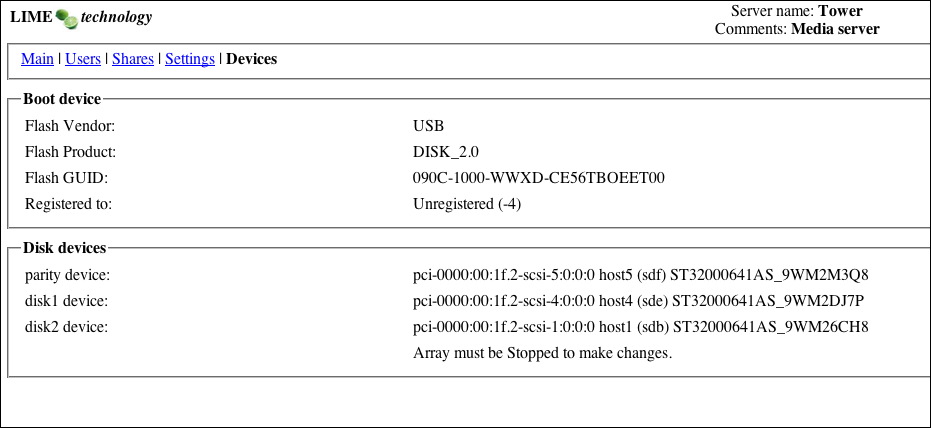

Yes! We were able to get it to boot. Instead of formatting the flash drive on my Mac I used son's PC and and made sure to use the make bootable function.  However we are not able to access the server using the previous IP address. Would the IP address have changed because of a new motherboard?
Most likely if you have a router that auto assigns IP addressess. A new Mac usually is a new IP address.
Log into your router and you should be able to check the IP address otherwise (for windows) you may be able to get there by typing 'tower' instead of the ip address
Josh
The IP suggestion worked thanks!
