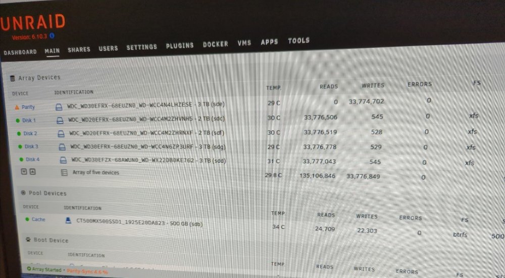

It said something like parity was invalid. The parity disk wasn't coming back on even after a server restart, and the only option seemed to be a parity sync, which lead to disk 2 showing an error. At first it showed all disks were fine but then disk 2 started returning an error.
I'm doing a parity sync right now. I haven't noticed any data missing in my network share so I'm hoping it will all work out, except my apps seem to be gone for good.
I reinstalled jellyfin, and when opening the webUI, it looked exactly like it was before, so I assume its retaining everything from the appdata directory. My docker is definitely on my cache drive too, so I don't know how it got wiped simply because the parity disk stopped working.
As seen here, its rebuilding with no disk 2 or 3 errors.
If I hover over the parity exclamation point widget, it says "parity is invalid", but I assume that will go away once it rebuilds.

Please do screenshots instead of photos. Can't see whether or not disk2 is unmountable, since you didn't get that part in your photo, but diagnostics showed it not mounted.
Sorry I'm kind of stuck with photos right now because my internet isn't working (currently posting from mobile data).
