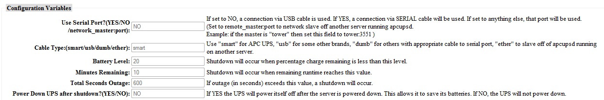

It also did a clear powerdown, regardless that that was wrecked by my idiocy.  Short novel to ensue: I had planned to run a parity check at the 36 day mark to Level 2 certify the motherboard I use today.  I felt "ballsy" a bit, so I decided to go ahead and test the UPS, semi-worst case scenario is that it doesn't do a clean powerdown, thus I would have to run a parity check after I start the server back up.. something I want/need to do anyway.  So, I proceeded to unplug the UPS.. warning indicator beeps from the UPS, LCD status display showing remaining minutes, etc.  everything was running smoothly thusfar.  Proper log made in the syslog that I had lost mains power and the UPS had taken over, good deal.  Well this is my config for the apcupsd package:
Use Serial Port?(YES/NO/network_master:port):	 NO
Cable Type:(smart/usb/dumb/ether):   smart
Battery Level:	10
Minutes Remaining:	5
Total Seconds Outage:	300
Power Down UPS after shutdown?(YES/NO):	YES
So, I go for an extended coffee/smoke break, return, the server is off.  Good deal, maybe I says... I turn on the server, excellent, a clean proper shutdown, array is up humming along.. awesome.  No tweaks needed with the apcupsd package to get my CyberPower to work (it is connected via USB for those interested, I'm using "smart" because it was my first selection in the testing process -- and it works so I intend not to fix what is not broken).  Great... so I plugged the UPS back in considering my test a success.

Turns out, the last setting  "Power Down UPS after shutdown?(YES/NO):" I suppose doesn't work quite the same for the CyberPower as it does for an APC.  That or I simply don't understand why such a setting would exist.  My guess is though, on APC's setting this to YES will shut it down entirely.. AC inversion, battery charging, etc, etc. on my CyberPower however, it shuts down the "power" (as in power switch on the UPS) so that even if it is receiving mains power (in my case by being plugged BACK in, in it's normal case, electricity being available again) it is NOT charging the battery and it is STILL running off battery.
My guess is this option may replicate pressing the power button on an APC.  If that is the case, then us CyberPower users need to figure out how to have apcupsd pass TWO power button "presses" if this option is set to "YES" or, simply use "NO."
First power press on the CyberPower will turn off "BIAS" power (thus switching to battery AC inversion) and stop battery charging.  Pressing a second time turns it off completely, no bias powering, no battery AC inversion, no battery charging, do not pass Go, do not collect $200... off.
I'm still pleased with the unit, considering how long it will run the server.. now that this has served as a friendly reminder to tweak my settings of the apcupsd package, I'm going to make use of it's 30-50 minute charge just a bit more I think.  And I'm going to change the "Power Down UPS after shutdown?(YES/NO):" to "NO".

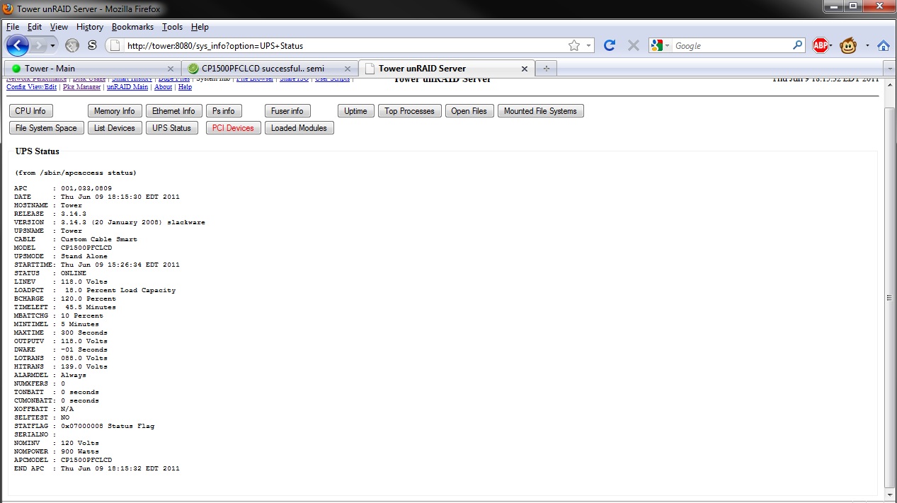

Attached is the UPS status from unMenu, I believe it may still be charging, unsure, didn't bother looking while I had it in Paint.
