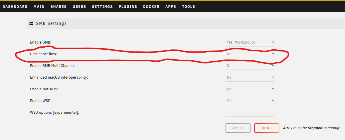

Check the status of this setting:
If that is not the issue.  Then try to do it without using rsync.
I just tested using a Windows 10 computer.  I, first, created a folder and a file beginning with an underscrore.  Then I created a folder beginning with a '._'  and generated a file in it with a '._' prefix.  No problems in either case.

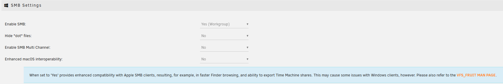

37 minutes ago, KristofG said:
the only difference is 'enhanced macOS interoperability' is set to Yes - was a default because i'm sure i didn't temper with it.
I believe it is not the default BUT is often required for the macOS to function
(If you point you cursor at the 'Enhance macOS...', you will see the help for that function listed....)
