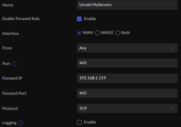

August 23, 20224 yr Hello. So I had an issue with MyServers and saw I needed to "Provision" the SSL. I went to Management Access and see the following: So I went to my router and set the following: After doing this, I still get the server is unreachable. Any thoughts?
August 23, 20224 yr Instructions for setting up Remote Access are here: https://wiki.unraid.net/My_Servers#Configuring_Remote_Access_.28optional.29 If that doesn't help, please upload your diagnostics.zip file (from Tools -> Diagnostics) so I can understand the current state of the system. Also, I highly recommend port forwarding something other than 443, to make it harder for script kiddies to find you.

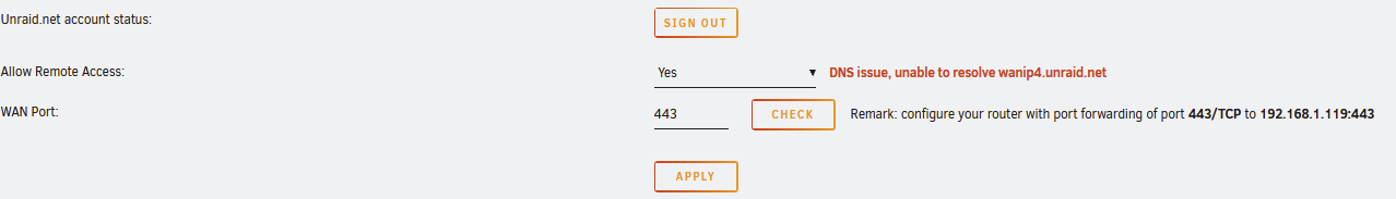

August 23, 20224 yr Author 20 minutes ago, ljm42 said: Instructions for setting up Remote Access are here: https://wiki.unraid.net/My_Servers#Configuring_Remote_Access_.28optional.29 If that doesn't help, please upload your diagnostics.zip file (from Tools -> Diagnostics) so I can understand the current state of the system. Also, I highly recommend port forwarding something other than 443, to make it harder for script kiddies to find you. Thanks for your help. I was able to get it Lastly - I am also getting another error. Is there any "quick fixes" here. While I know i can upload Diagnostics, I've found there are several things I need to go in to the outputs and further "anonymize" before uploading. Note that I saw this may be related to Pihole -- however, I am not running pihole on the network Edited August 23, 20224 yr by Hawkins12
August 23, 20224 yr The fix for DNS issues is to go to Settings -> Network Settings and set the DNS Server to 8.8.8.8 Diagnostics are already anonymized, if something needs to be anonymized further that may be a bug.
