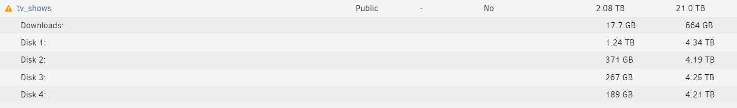

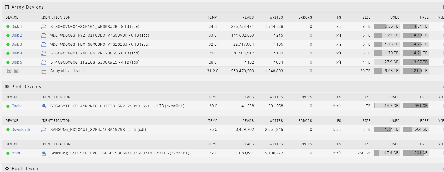

A few days ago I finished backing up my unRAID server and I've only recently finished returning all my data back onto it. I have 5 drives which form the array, then I have 3 cache pools. 2 of the cache drives are used for appdata, vm's etc, and the 3rd one is for any downloading.
I have been downloading a few torrents and I have had issues with Sonarr and Radarr not importing, so while I sort this out I have been using Krusader to move these media files into my library. What I couldn't work out was why I haven't been gaining space back on my Downloads drive.... well, I have figured that out; they are still there!
NOTE: none of my media shares have a cache drive. In the above example, the share is only allowed to use disks 1 to 4, and this has always been the case. This issue has occurred only because I used Krusader.
I am hoping I can get some assistance on what I need to do to remove the data from my Downloads disk. I am also hoping to get some help with the best way moving forward..... should I actually make my Downloads disk the cache for my media shares? Then when MOVER runs it will clear the drive for me. Would actually making the disk the cache drive right now before moving any files, resolve this issue?
