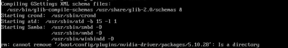

Moved my unraid installation to new hardware, i have the following problems:
1. Cannot ssh to the server, do i have to delete some keys to have them regenerated based new hardware? If so, where do i do this?
Sep 17 14:03:23 NAS sshd[11266]: Connection from 1.1.1.4 port 51163 on 1.1.1.7 port 22 rdomain ""
Sep 17 14:03:23 NAS sshd[11266]: Unable to negotiate with 1.1.1.4 port 51163: no matching host key type found. Their offer: ssh-rsa,ssh-dss [preauth]
2. Some error in the boot regarding removing an nvidia plugins folder, not sure if i need to bother with this but i've included the message in the picture below.
Everything else so far seems to work good!
