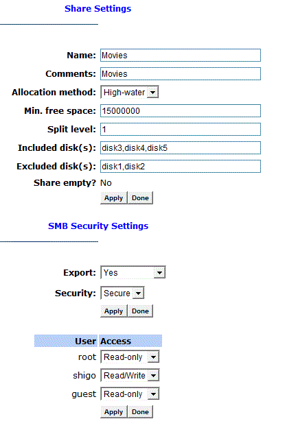

Currently I have 2 shares and in the unraid menus I can only set each user to read only or full rights to the share.  In the tutorial it said I can make it so users don’t have rights to the share, is this changed or am I missing something?  Also when I do set the share up it is not active and everyone has full access to the share

You must have the Plus or Pro version of unRAID license in order to define per-user permissions.  You must change the security type on the settings page to User-Security.
I did and i have here is what i see in my share.  Like i have said each user in the share only has 2 choices read only and full, there is no restricted access.

In pre-5.X versions there is a setting for share security.  I don't know where it is set in the new 5.0beta7.  I could not find the equivalent.
I think this is where i am having problems  :'( I cant find where i can do more advance share security.  I would love any help finding this settings.  I would rather keep the default webgui, but if the one that "speeding_ant" is posting is better then i guess i can change.  Can someone post the share user security menu on that webgui?
There is NO difference in the GUI's (well a little but...)  The webGUI speeding_ant put out is a SKIN of the original unRAID webGUI to make it look prettier.  He has added a few things but NOTHING in the way of what you are talking about.
I have been playing with this and still can’t find the right settings.  Is there documentation on how to manually edit the cfg file on the shares?

Yes I’m the same way about seeing it in network places.  I am more conserved about the inability to restrict access to shares.  I have seen screen shots of the shares in 4.7 and how you can add and remove users in different categories of right, but for the life of me I don’t see a section like that and what I have found doesn’t seem to work.
Did you ever think it might not be part of the interface on 5.0 yet?  But nobody noticed it is missing yet? since we mostly are upgrading existing arrays with existing defined permissions.

First I am using 5beta6a not 7, next I was hoping someone would point out if it’s a problem with my unraid settings or if I was just blind.  I don’t want to post problems with something unless I know it’s not my fault.  I appreciate your fast response and I was hoping just to get confirmation from one more person before take human error out of the issue.  I will post this issue on the correct forms.
no problem.  As I said, you are probably the first to ask the question on the 5.0beta series.
I looked through my 5.0b6a install on my two systems and my findings are the same as yours.
Same here.
One wild guess is it's easier to shoehorn this in late, after AD support is worked out, vs. the reverse.
