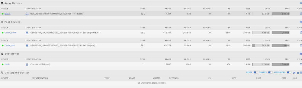

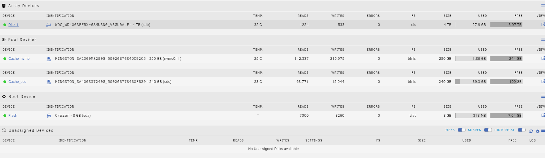

September 22, 20224 yr Author 4 minutes ago, ChatNoir said: And maybe a screenshot of the Main page. 5 minutes ago, JorgeB said: Please post the diagnostics. Here are the diagnostics and main page. bagaserver-diagnostics-20220922-1110.zip Edited September 22, 20224 yr by ViiRaLe
September 22, 20224 yr Community Expert Not sure how the usage could be of by that much, df is reporting the same, what kind of files do you have there? Media type or more compressible files?
September 22, 20224 yr Author 16 minutes ago, JorgeB said: Not sure how the usage could be of by that much, df is reporting the same, what kind of files do you have there? Media type or more compressible files? I have mostly media files (1.3TBs more or less), 100GBs of isos and some other file. Even the reads and writes are wrong. Edited September 22, 20224 yr by ViiRaLe added info

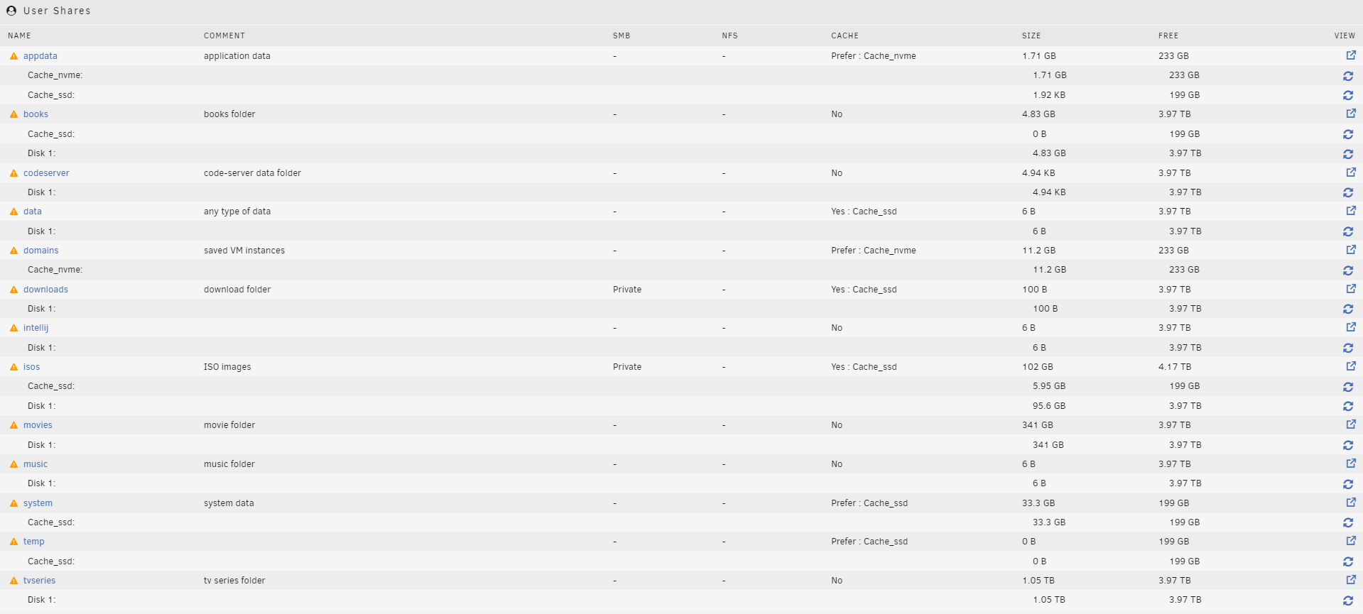

September 22, 20224 yr Community Expert Go to Shares, click on "compute all" and please post a screenshot of the results.
September 22, 20224 yr Author 13 minutes ago, JorgeB said: Go to Shares, click on "compute all" and please post a screenshot of the results.
September 22, 20224 yr Community Expert Strange, there's clearly more data on disk1, check filesystem on disk1 to see if there's any change.
