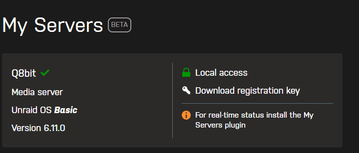

September 24, 20224 yr So I just updated my unraid to 6.11.0, but I am now unable to access the unraid webGUI, and the local access isnt available it just transfers me to the xxxx.myunraid.net which gives me a 404 error. however I do know that it is functional 100%, my VM/dockers are working. I just don't have access to the main webGUI. is there a way to edit files off the flashdrive or something to disable "my-server" and go back to Lan/local access? just to update the thing. Thanks.
September 24, 20224 yr Community Expert See if this helps: https://wiki.unraid.net/My_Servers#How_to_disable_SSL_for_local_access
September 24, 20224 yr Author 13 minutes ago, JorgeB said: See if this helps: https://wiki.unraid.net/My_Servers#How_to_disable_SSL_for_local_access when I try http://IP:Port says "400 Bad Request The plain HTTP request was sent to HTTPS port nginx" --------- when I try https://IP:PORT "404 Not Found nginx"
September 24, 20224 yr Author Solution I edited 'config/ident.cfg' file off the flashdrive and changed SSL = Auto to SSL = Off and was able to access it locally.
