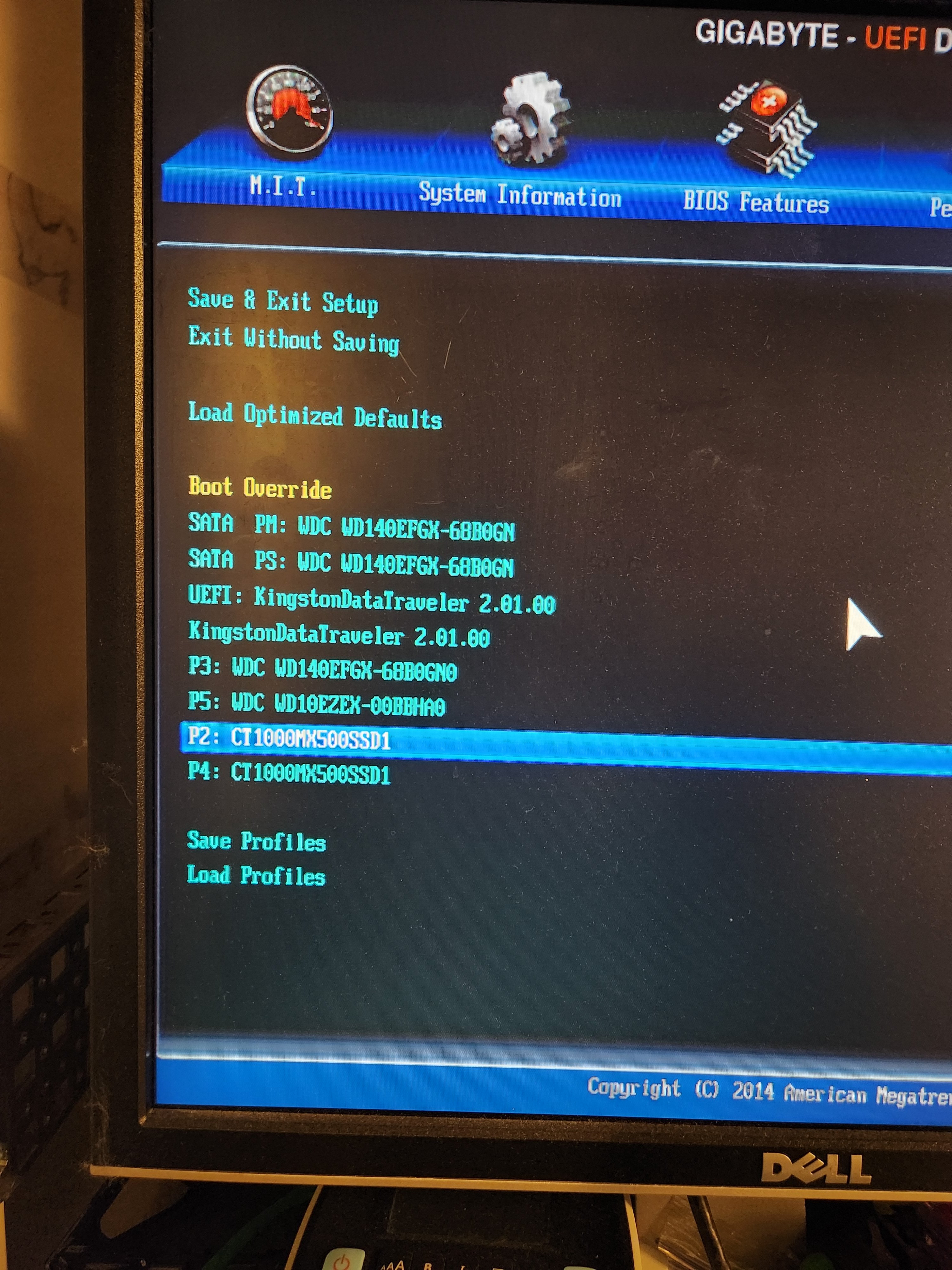

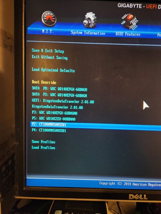

This morning, after shutting down and then booting to the bios, I can see that the bios does see the drives. I exited the bios and let unraid boot and everything mounted without any issues. I'll be keeping an eye on how long it stays up and get diags before rebooting if the drives drop off again. I find it surprising that both drives went offline at the same time, but I know that without better diagnostic information it'll be difficult to establish a root cause. I will update here once I'm able to produce diag information.

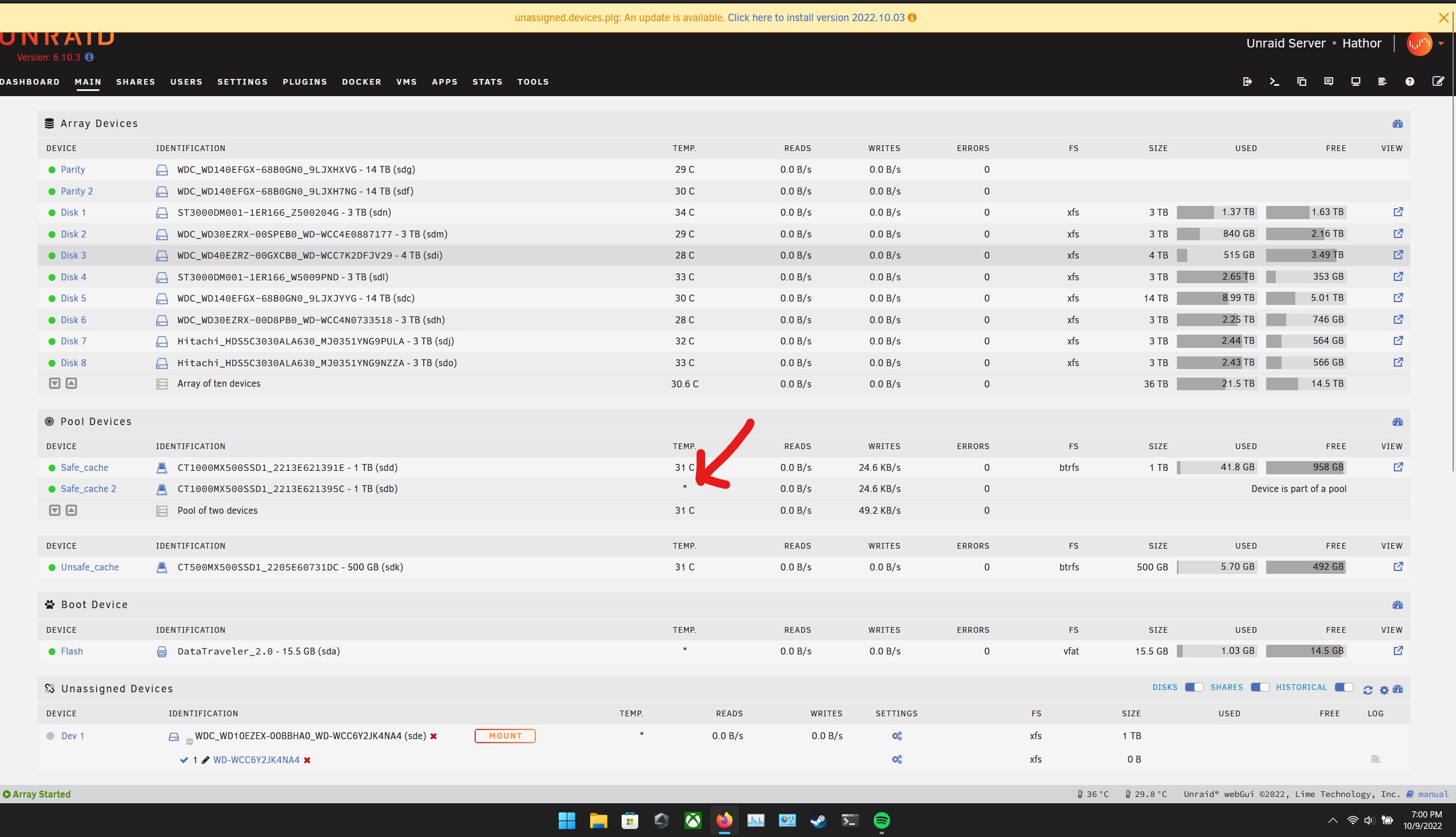

Ok it's happened again, unfortunately it seems to have happened a few days ago and I wasn't able to get logs right away and /var/log seems to be full, regardless I've captured these diagnostic logs and plan to install the update to 6.11.0 and reboot after.
I've included a screenshot that highlights that one of my two cache drives have gone offline - the easiest way to see that this has happened is that the temperature readout shows * instead of an actual reading.683193757_Screenshot2022-10-09190055.thumb.jpg.f8984e6a2394f7163d6fe5d7ce1f6ff9.jpg

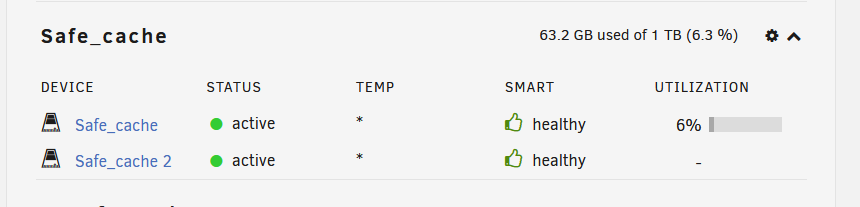

What's frustrating is that Unraid actually doesn't mark these drives as offline, even though they have been disabled per the logs:

See the attached image - the temperature being an * is the only indication that something is wrong.
