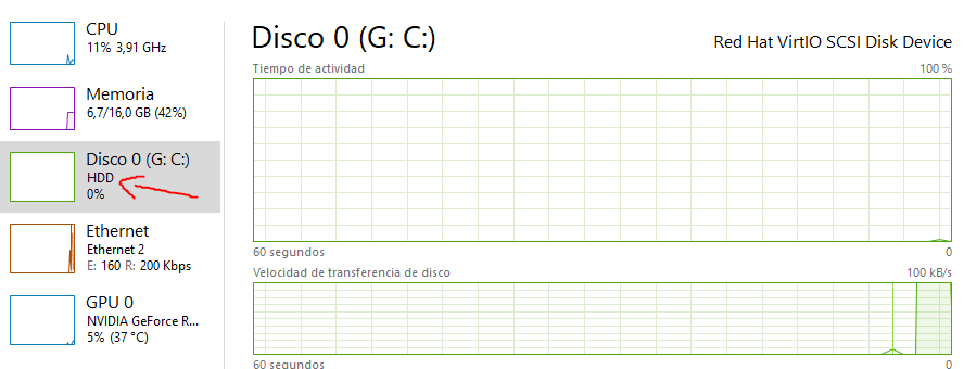

I have a Windows 10 VM inside Unraid phisically residing in the SSD cache. The "C:" drive is a thin provisioned file (not passthrough), and G: is just the Google Drive virtual unit stored inside C:. It has all the Red Hat virtio drivers installed and so on.
However, Windows detects the device as an HDD in task manager instead of SSD. In the defrag console it displays as "thin provisioned disk" (sorry, the picture is in spanish).
I'm guessing Windows is not taking the full advantages of an SSD, and possibly not using TRIM. Questions are:

Thank you for your reply @JorgeB. As I mentioned in my original post, I already did that but "HDD" still shows in the task managr. Does that mean that "HDD" is going to show regardsless? Should I not worry about that?
That's not a problem, to show as an SSD you'd need to pass-through the device.

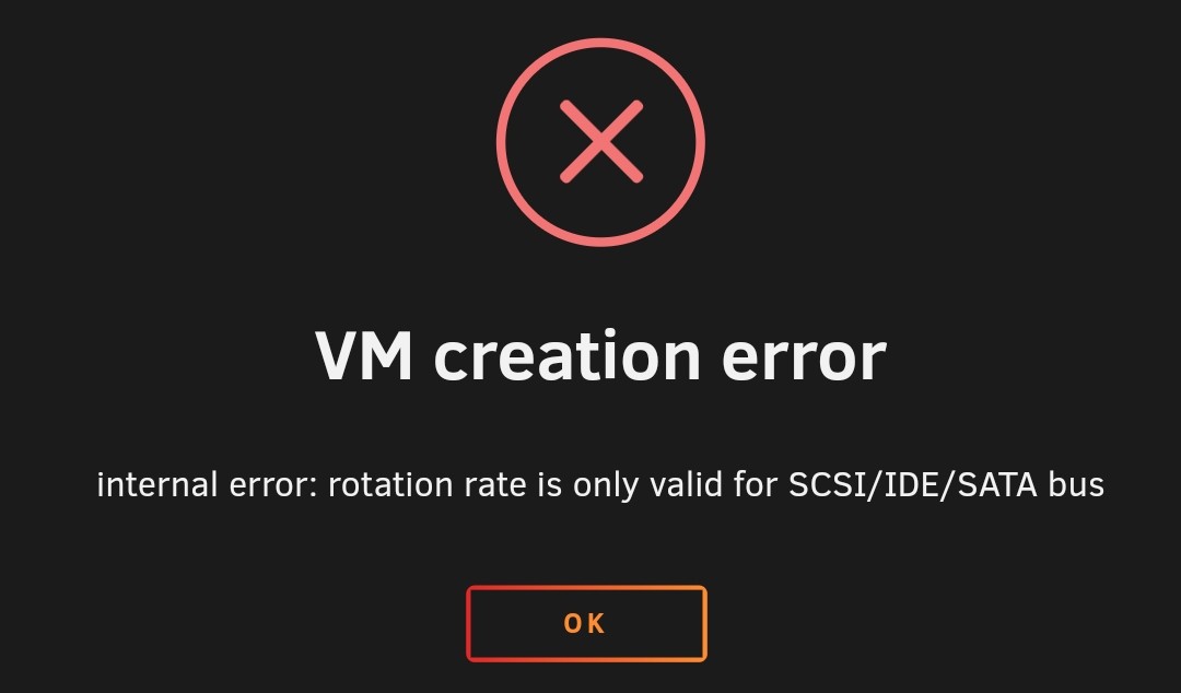

Thanks. I tried adding rotation_rate='1' as you suggest but it errors saying it only works with SATA, SCSI or IDE.
It's Virtio so I tried changing it to SCSI and the VM blue screens to death. I had to turn it back to Virtio and remove rotation_rate='1'
true, sorry, virtio is not compatible with rotation_rate
