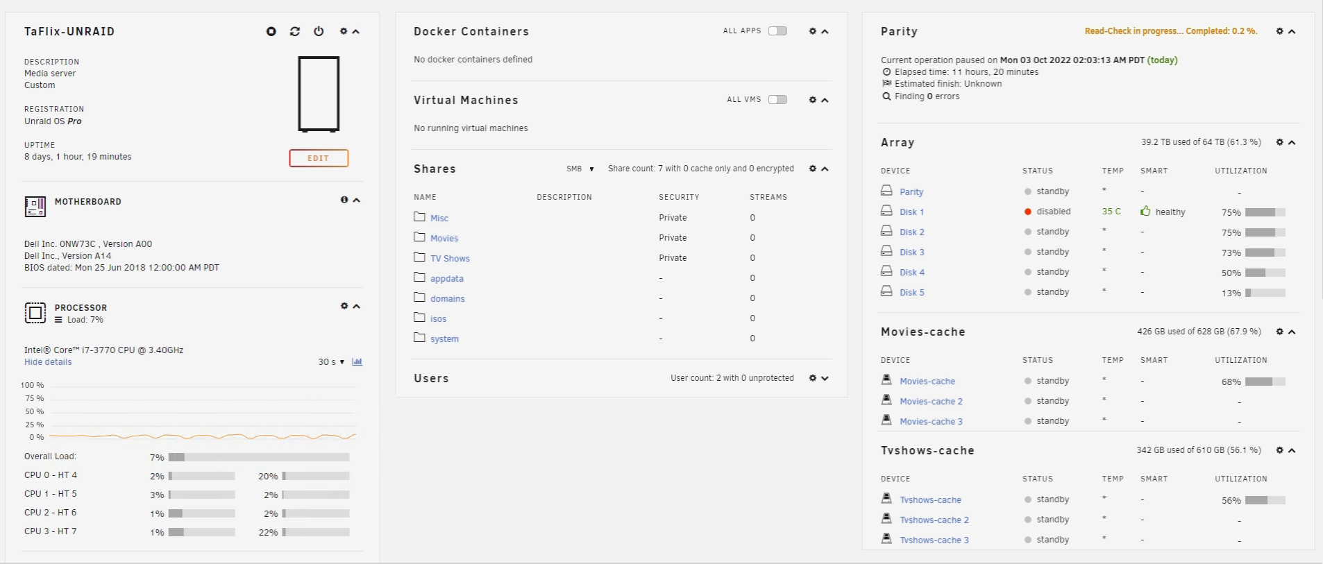

14 minutes ago, taflix said:
don't see any Smart warnings on the DASHBOARD page?
Maybe you already acknowledged it. Or maybe you aren't looking in the right place. Post a screenshot

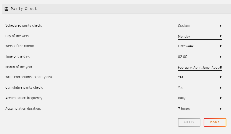

15 minutes ago, taflix said:
What am I doing wrong?
One thing you are doing wrong is having scheduled parity check set to correct parity errors. You don't want to corrupt parity if another disk or other problem such as bad RAM is causing parity errors. You should set the scheduled check to NOT correct parity, and then if there are parity errors, you can decide whether to correct them by running another parity check.

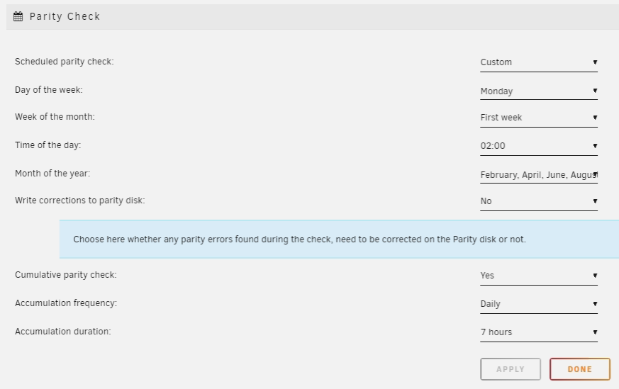

Okay, thanks.  I didn't know that was a best practice thing and fixed it.
Is this where I should be looking?
yes

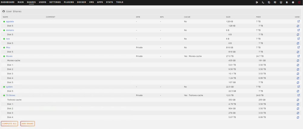

Go to User Shares, click Compute All button at bottom, wait for results, post a screenshot

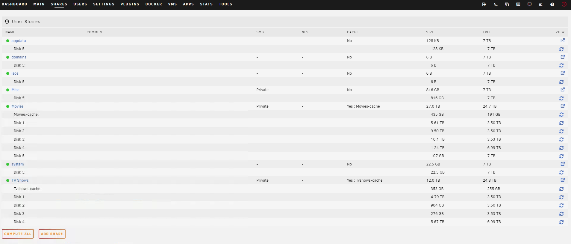

I think you are good, except your appdata, domains, system shares are on the array. Ideally these would be on a fast pool. Docker/VM performance will be impacted by slower array, and array disks can't spin down since these files are always open
