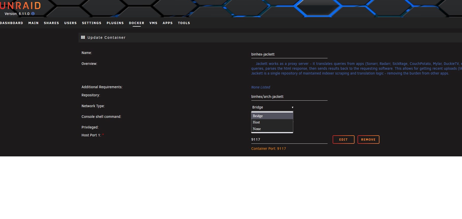

Hi my Backup Unraid Server seems to have a problem. I run it nightly to backup from my Main Server so I rarley actually turn it on. Today I turned it on and found in Docker the Network Type: Custom is missing I have Bridge Host None but no Custom.
How do I get that back please ? as I need to give my Docker Containers Static IP addresses. It used to work pefectly.
Please see Pic attached and I attached DIagnostics to.
Any help would be great I love Unraid used it for many years.Unraid.thumb.jpg.d85e3c7ecd793bf3808d0a8a6dcba794.jpg

Solved by Squid
Settings - Docker with the service disabled
Brilliant thank you so much fixed it perfect :)
