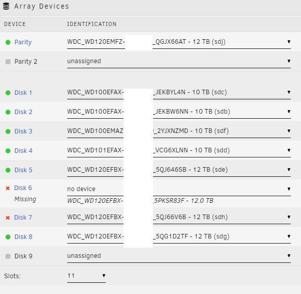

Morning all, I am having an odd problem. I have an Unraid server running 6..10.3 with a 10-disk array filled with WDC_WD10 and WDC_WD12 drives. I had one drive failure, but the array kept working as it should. However, after I moved a few things around to try and accomodate a new drive, another one of teh drives seems to not be joining the array, and I can't restart it. The odd thing is that the drive is right there: unassigned devices can see it.
Let me show you what I mean. First in the attachments is the list of drives from the main screen. 7 is the failed one, and 6 is the one I am having problems with.
When I use the drop-down for drive 6, no devices are listed

I suspect I may have had two drive failures, and the only thing I can do is to delete teh array then rebuild it with the working drives and recover what I can
Any other ideas?

Disk7 looks healthy, if nothing was written to it after it got disabled it might be possible to re-enable to rebuild disk6, other option is doing a new config without disk6, or with a new disk6.
