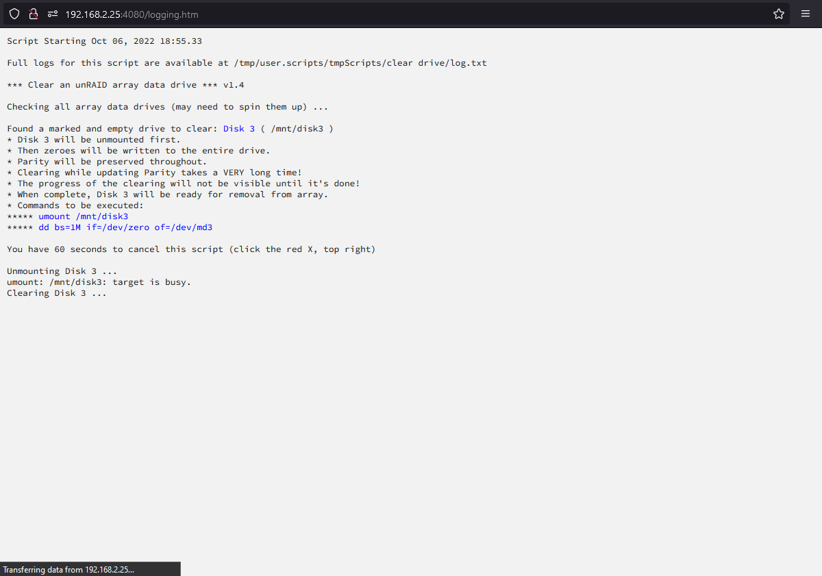

I decided to clear a 1TB SSD, so I started the script last night. It is now morning and the script is not done and I see that it is still writing to the disk and the parity drive.

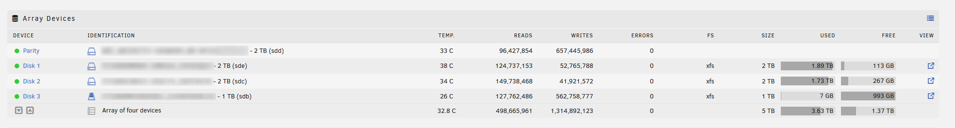

I enabled reconstructed write. The array consists of 3 data drives and 1 parity drive. All of them (including parity) are 2TB except for the SSD that I'm clearing which is 1TB. The parity drive is a WD Red drive (I think it's SMR), but even if it was slow, I would have expected it to complete by now. What do you think?

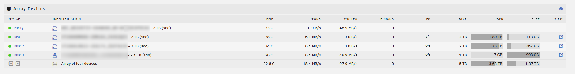

Click on this to see how fast it's going instead of the useless number of IO.

But the script doesn't say much
At 50MB/s it would take about 5.5 hours, if you had reconstruct write off before it might have been even slower then.
But the script mentions it failed to unmount the disk, so that may be a problem. Did you still have shares set to use it, or a shell open in it when you ran the script?

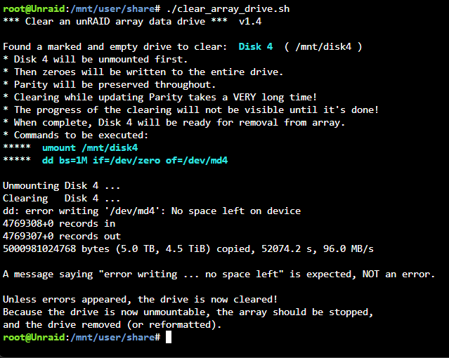

The script does a du -s on each disk to check whether it's empty, that can take quite a while depending on what you have on your drives. But that's before the confirmation prompt so OP is past that, after that all it does is unmount the disk and the same dd you'd do manually so it's just limited to the array's write performance.
In my case I've commented out the du since it would probably have taken hours with my drive contents. Script should ideally check for marker first and only do a du to check if it's empty on drives that have it already instead of all of them.
The complain has been the clearing speed, like 5 or 10MB/s even with reconstruct write enabled.
It runs exactly the same command you have in your post about doing it manually. If it's slow it's the array being slow :)
My guess would be those who have terrible performance have it because of SMR drives, it is a large write operation after all. Or concurrent accesses.
