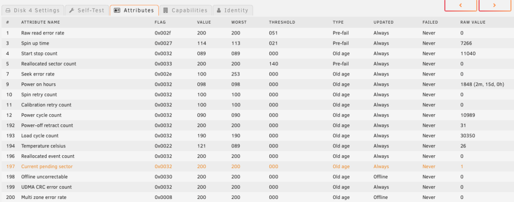

Recently I emptied an older 1TB WDC drive and added it to the array.
It was originally one of those desktop usb style drives that i gutted and installed into the server.
This morning, during the scheduled parity run, the drive has been flagged with read errors.
SMART report attached along with its attributes.
Should I retire this drive? or is it still safe to use for a little longer.

It's logged as disk problem, you can run an extended SMART test to confirm, it it fails replace it, or depending on the situation, you might try to do a full disk write, pending sectors should go back to zero then see if they come back again soon or not.

Try as I might, SMART extended test kept returning read errors... so guess that's a negative for continued use.
I tried unsuccessfully to remove it from the array. My fault for not following the instructions properly. But its now gone.. yay... sort of.
