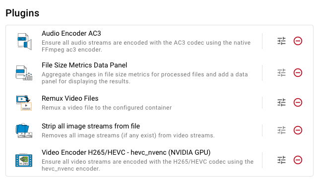

Quadro M2000 as just a transcoder. Possible?
Hi @ich777, cheers for replying. I certainly wasn't expecting that 🙂 Re watch nvidia-smi, it won't make any difference as the Pending Tasks Queue doesn't have any items it to process. I can watch the progress of the unmanic search the files /folder when pressing "RESCAN LIBRARY NOW", but by the end.. there's nothing for it to do. The Plugin Flow, which is now located in Settings -> Library -> Configure (different from the youtube vids), has the following configure, but the "Library Management - File test" just doesn't want to know about any files and doesn't seem editable. 😞 Oh well.. 😞
@ich777. I tried unmanic and well... nothing happened. According to the docs: "Simply point Unmanic at your library and let it manage it for you."... Yer well.. ahem!.. that did nothing. Watched a year old youtube video, and installed some plugins. But again.. nothing. Pressed the "RESCAN LIBRARY NOW" button (why is it all in caps?), and I can see it looking at the library, but all that comes up in pending tasks are a couple of mp3 audio files... like.. what the. So sadly, gave up on Unmanic or every using NVIDIA on Unraid.... on well.. cheers anyway @ich777 👍🏻
