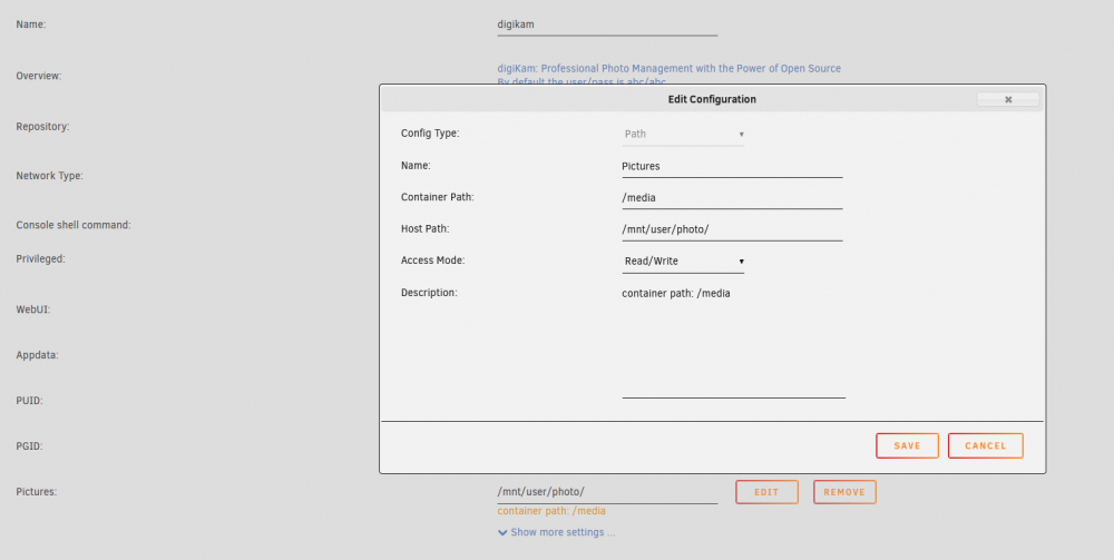

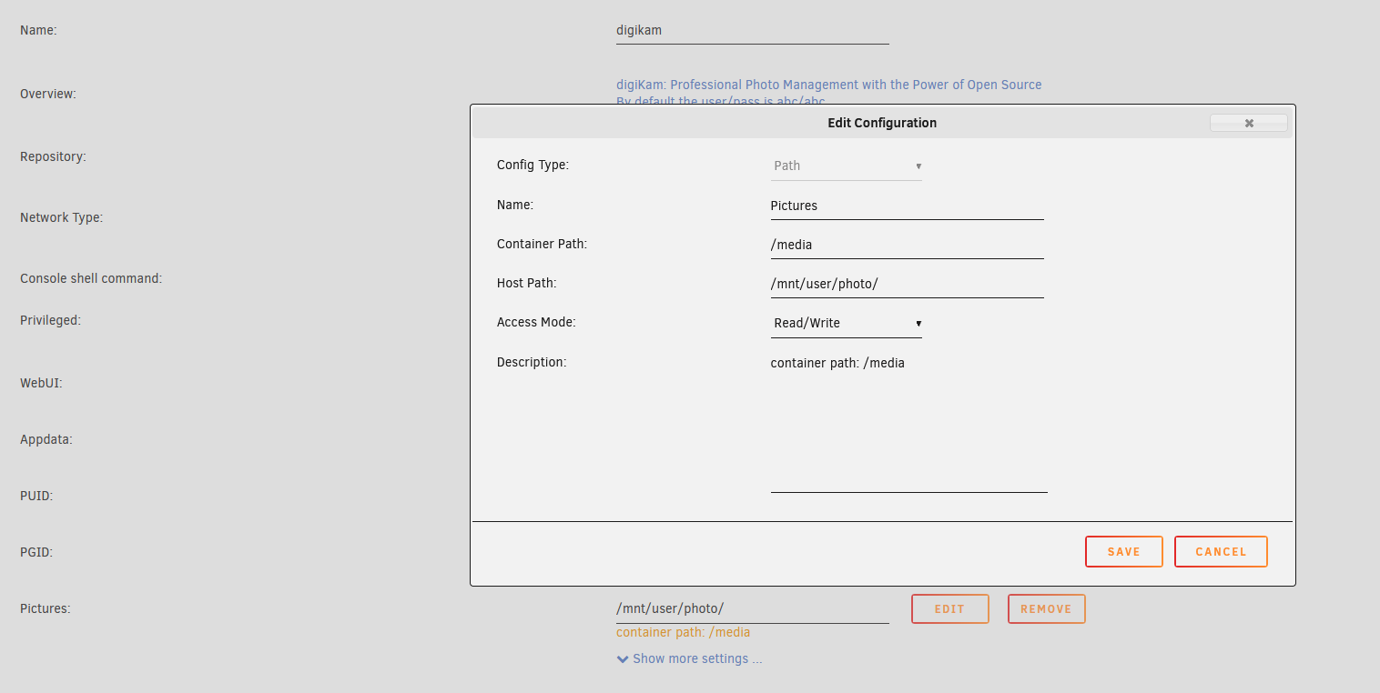

January 21, 20215 yr On 1/17/2021 at 5:11 PM, Jokerigno said: HI all, I've setup this docker and wanted to use it as my default solution. I shared nextcloud folder to simply import photos but the in digikam the option to add images from a folder is greyed out. Can some one please help me to understand how to change it? TY in advance This option is for already existing albums in digikam. You have to mount your photo folder in the docker container options. e.g.:

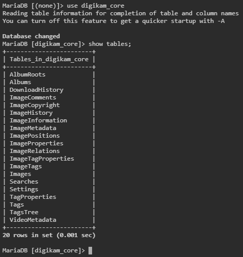

May 26, 20215 yr Anyone get this working using mysql remote (MariaDB)? I keep getting "Failed to create tables in database" I've tried using the suggested single database (selecting defaults fills the 4 databases with the name digikam) and I just tried naming them separately by using digikam_core, digikam_face etc... The database connection test passes, and database tables are created, but then I get the message. My latest attempt did create tables in digikam_core the other ones blank (digikam_thumbs, digikam_face, and digikam_similar). When I used the same db "digikam" for all 4 database the same 20 tables were created. Edited May 26, 20215 yr by Dmtalon
