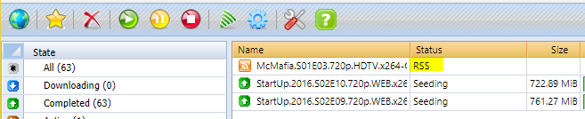

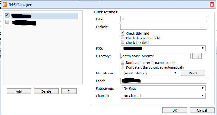

  10. should RSS be able to auto-download? I thought I had this setup working but now it's doesn't seem to. Torrents come in via RSS as a status of RSS and I have to manually click on them to load them.

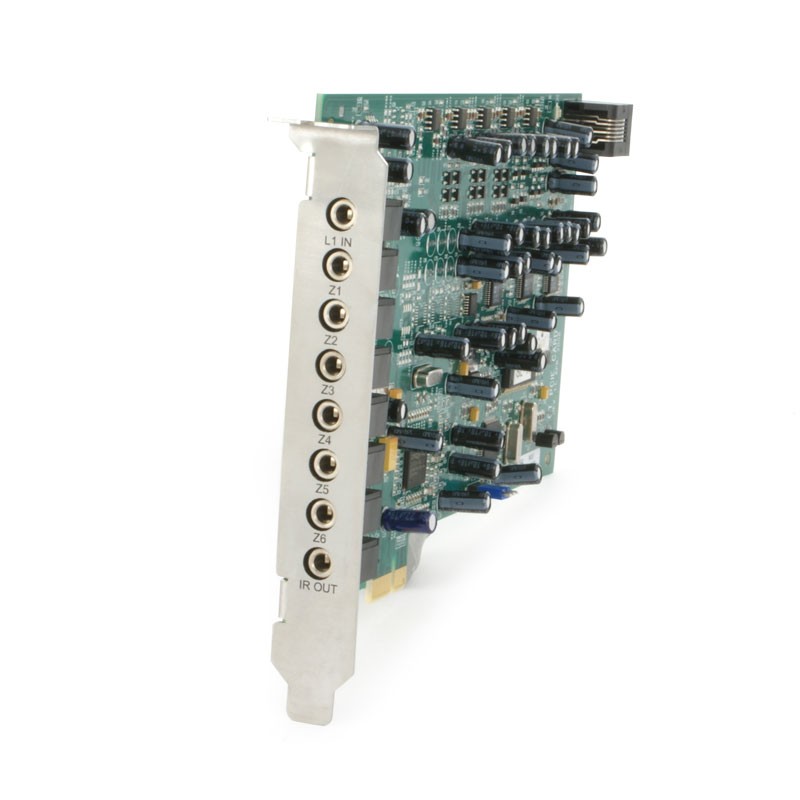

  11. 07:00.0 PCI bridge: Creative Labs [sB X-Fi Xtreme Audio] CA0110-IBG PCIe to PCI Bridge 08:00.0 Audio device: Creative Labs [sB X-Fi Xtreme Audio] CA0110-IBG 08 is what I'm passing through to my windows 7 VM. This is (I believe) a custom version of the SB X-Fi Xtreme card. It is a PCI card, and is for my whole house audio (Casatunes). Its a 6 channel audio card with an aux in and IR out. /usr/local/sbin/vfio-bind 0000:08:00.0
