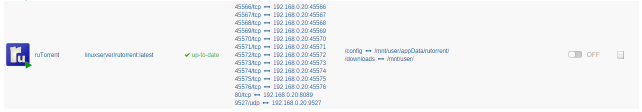

Can you post a screenshot of your setup... Like this...
Screen shot posted below.
Noticed your's looks different, but then I saw you were using 6.2 beta. :)
Thanks
