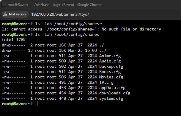

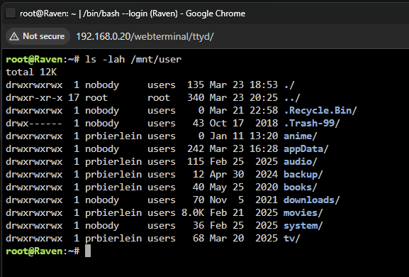

OK, so to make sure I'm following, rename all the .cfg files to .bak copy the .bak files changing their name to lowercase and also extension back to .cfg delete all the .bak files and reboot Is that the gist?

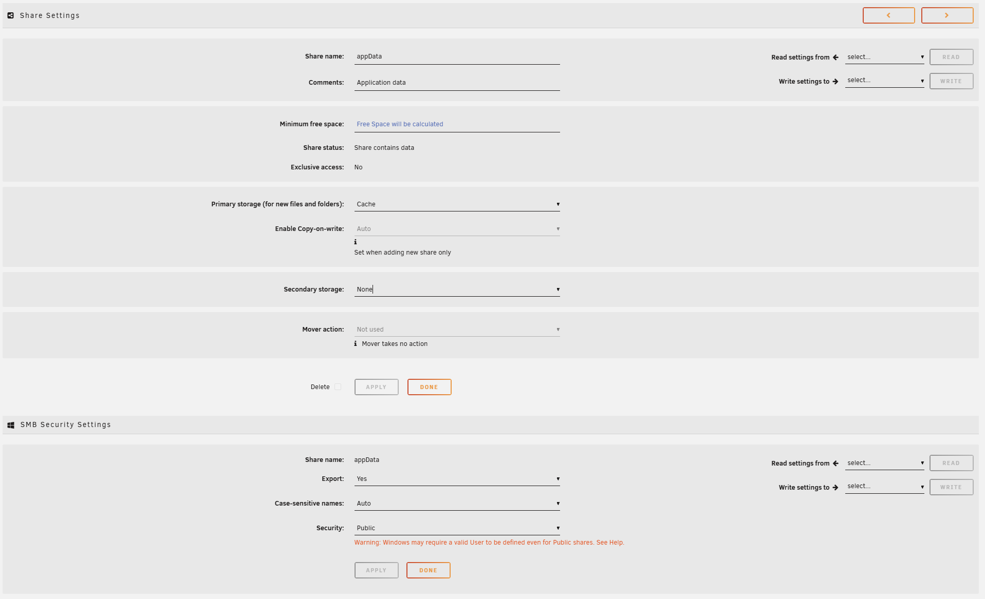

Updated from 7.1.4 to 7.2.4 over the weekend. Since the update my shares have gone weird for lack of a better term. The shares still exist on the server, but the SMB capability no longer exists (all but cache, downloads, system, and appData). All shares changed to Cache Storage even those I had set to Array and the option to change them is greyed out and cannot be selected. appData, cache, downloads, and system all look to be open to configuration and have a SMB security settings section at the bottom of the page, the others do not. If I try to manually move any files from the cache drive to the array using Krusader I get privilege errors. I logged out of my personal user account and into root but I seem to be getting the same issue even under root. Rebooted system, no effect. Rebooted into GUI Safe mode, no effect. Any ideas on how to fix this? Thanks.raven-diagnostics-20260323-1847.zip- Possible failed flash drive
