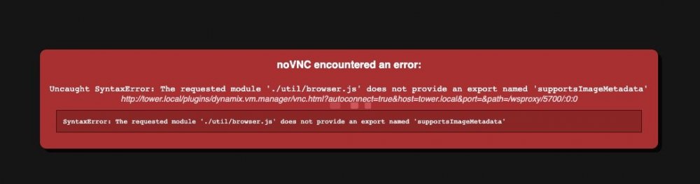

Getting failure to connect to VNC on my VM.

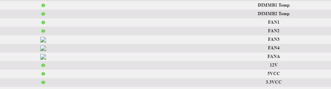

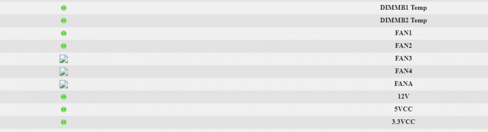

Some minor visual bug - on the dashboard tab, there is no icon for 'N/A' against one of the unavailable fans, I see a broken link instead
Can you post a screenshot
