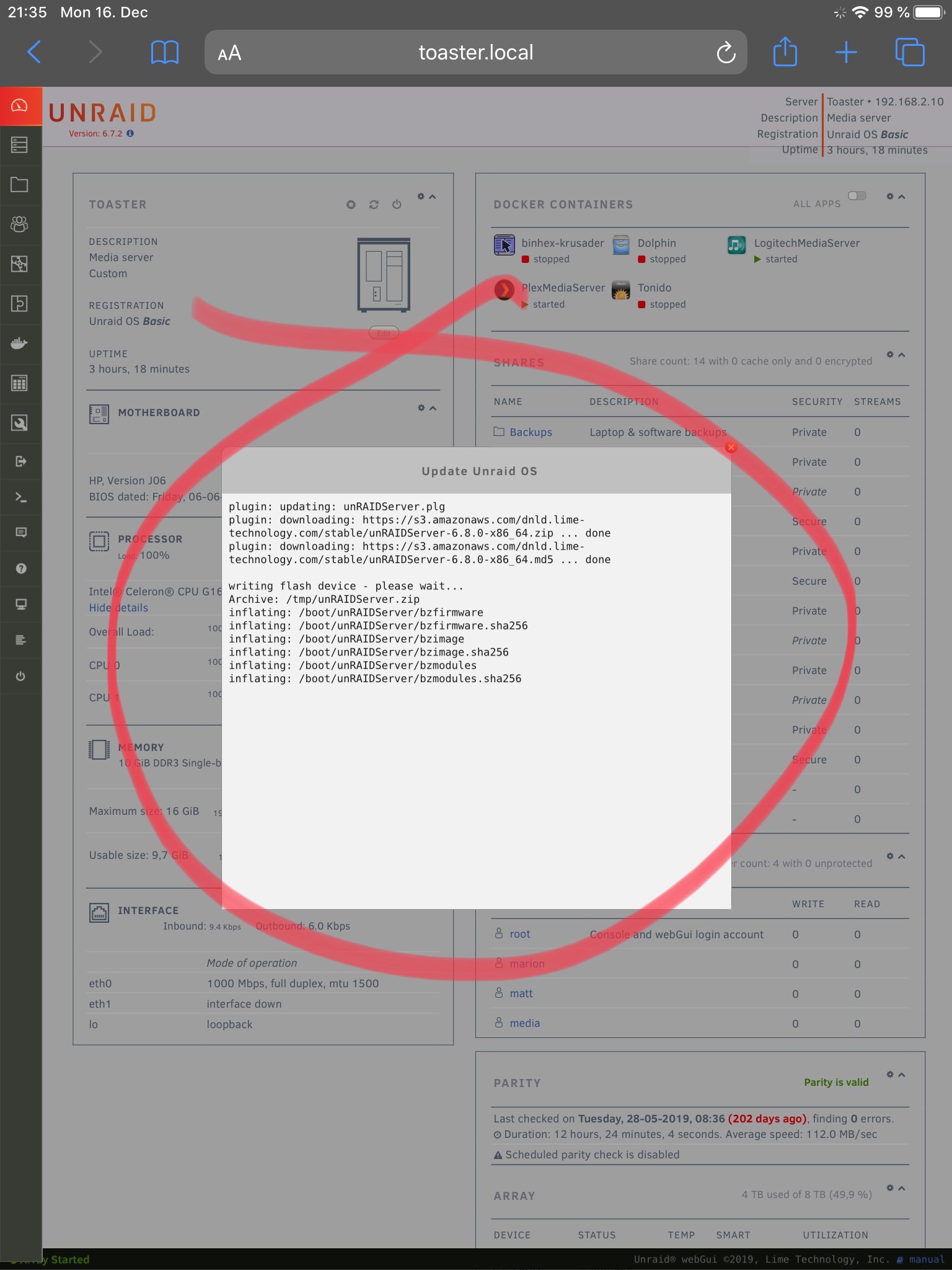

Hello. Unfortunately after upgrading from the last stable version 6.7 I believe, I can no longer reach the server at all. Putty won’t connect... it appears the server is not being allocated an IP address by my router. I did have issues doing the upgrade and had to try 3 times in order to get the process through.
See pic for where it got stuck.
Edited by johnieutah

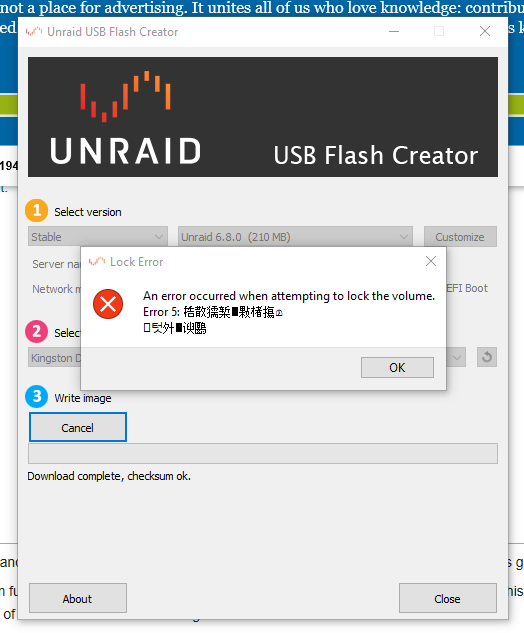

That's usually a flash drive problem, backup the flash drive's config folder, recreate it using the USB tool and restore the config from backup overwriting existing files, if it still doesn't boot try recreating the manual way.
Thanks for the advice. This unfortunately lead to the next problem...
