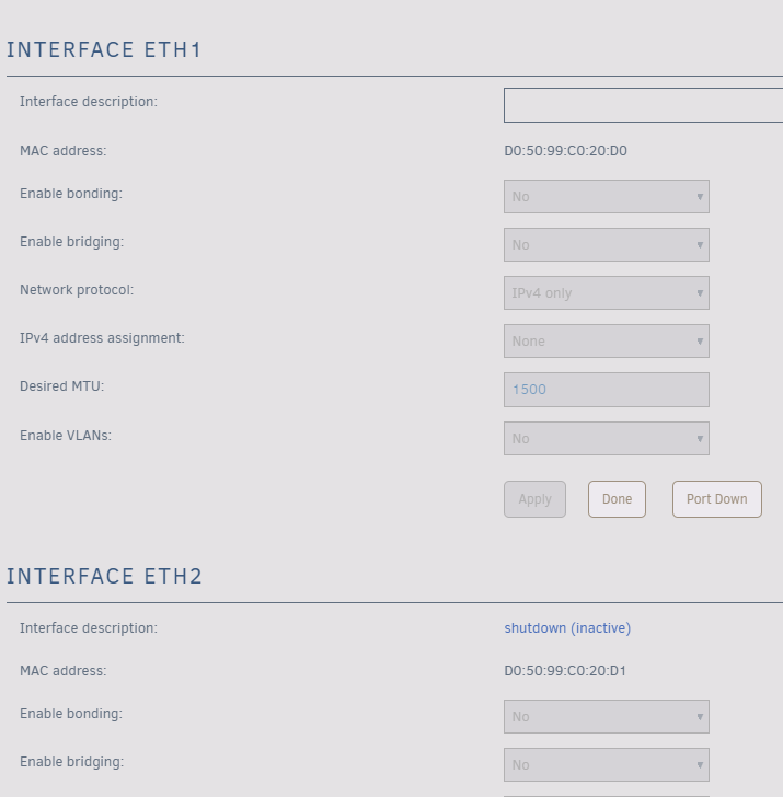

I just noticed a minor issue from long ago, and now have it resolved.  The system was trying to enable "eth1" when I thought everything was set to only use "eth0".  It was because network.cfg had SYSNICS="2" from a time when I did have multiple NICs enabled. Editing the file to have SYSNICS="1" and rebooting took care of it.
Network.cfg, from before the edit:
# Generated settings:
IFNAME[0]="br0"
BRNAME[0]="br0"
BRSTP[0]="no"
BRFD[0]="0"
BRNICS[0]="eth0"
PROTOCOL[0]="ipv4+ipv6"
USE_DHCP[0]="yes"
DHCP_KEEPRESOLV="no"
USE_DHCP6[0]="yes"
DHCP6_KEEPRESOLV="no"
SYSNICS="2"
Snippet of Syslog showing it's trying to do something on eth1 from before the edit:
Dec 15 15:11:00 REAVER rc.inet1: ip -4 addr flush dev eth1
Dec 15 15:11:00 REAVER rc.inet1: ip link set eth1 up
Dec 15 15:11:00 REAVER kernel: IPv6: ADDRCONF(NETDEV_UP): eth1: link is not ready
Dec 15 15:11:00 REAVER kernel: 8021q: adding VLAN 0 to HW filter on device eth1
Screenshot of Network Settings where Eth2 is shutdown, but Eth1 shows different than Eth2 from before the edit:
