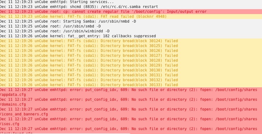

Unraid is attempting to start services.  The logs show scrolling errors:
Edited by DoItMyselfToo
Problem with the flash drive, try again after running chkdsk first or recreating.

Ran CHKDSK but no errors.  So ran FirstAid in Mac OS and it scanned and fixed the file system.  Unraid back up and running on 6.7.2.  Thanks for your help.
