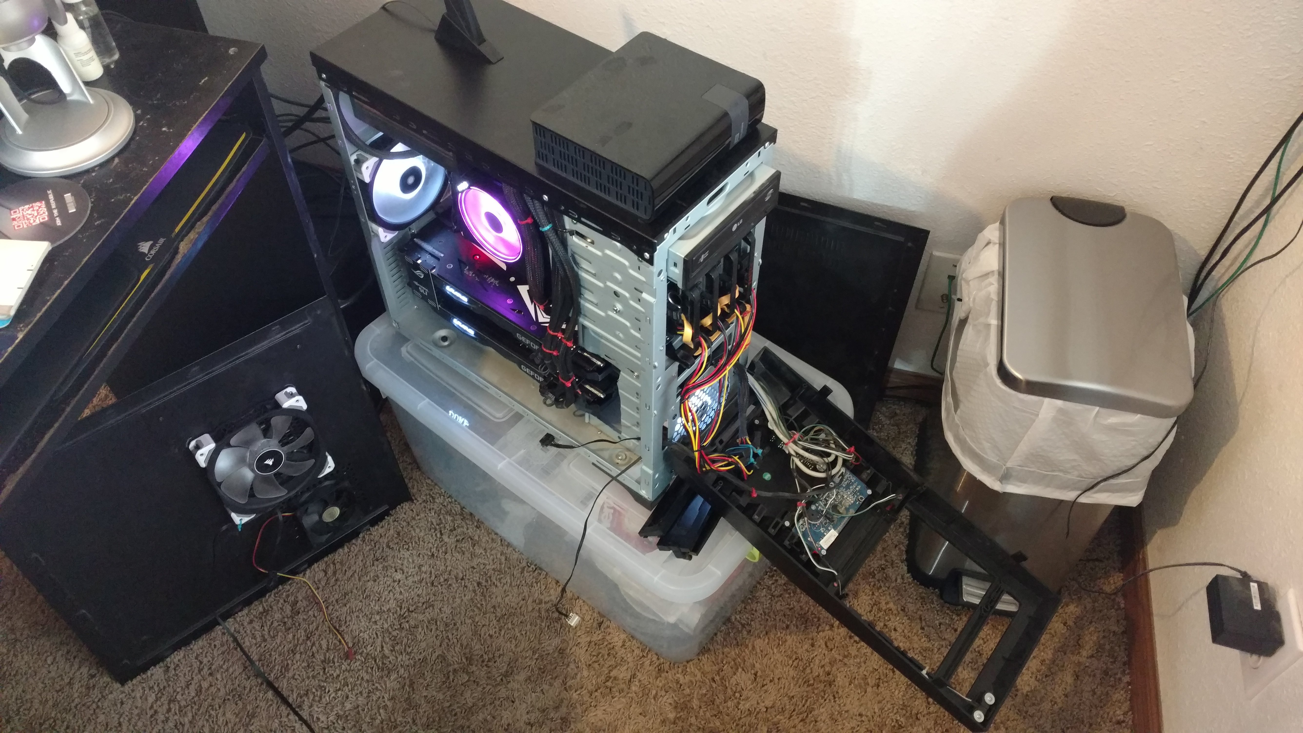

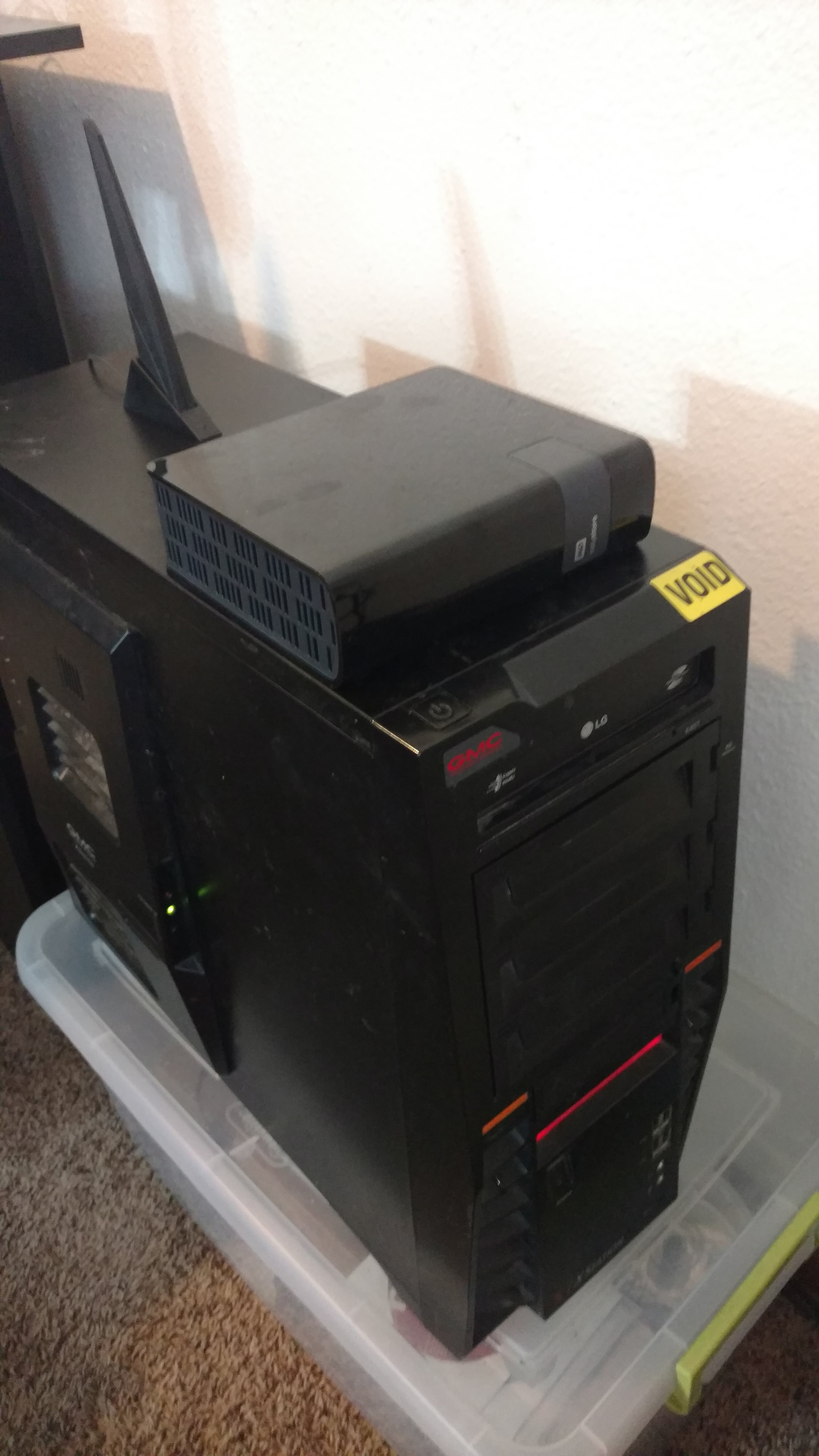

Work in progress, mobile all in one gaming/entertainment center. Main 4k gaming station with 3 28" surround monitors all wired Logitech gear, and full surround sound. Secondary 4k gaming rig with 1 4k monitor, and mirrored image to 4k living room and bedroom TVs. all wireless Logitech gear. Expandable NAS with unRAID PRO using 8tb WD drives with parity protection. Motherboard has onboard wifi with external antenna, able to cast 4k movies through walls over long distances. unRAID array has USB backup drives disconnected from the network. Still building and working out compatibility issues here is a pcparts list: https://pcpartpicker.com/list/WBV6ZR
