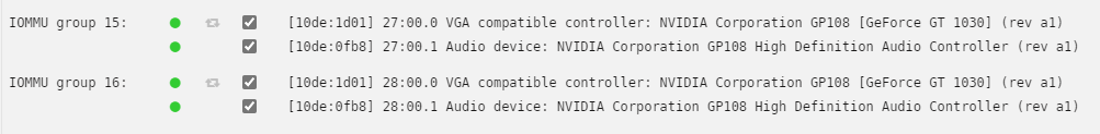

July 28, 20215 yr Hi All, Been searching all morning for an answer with not much luck. I HAD AMD and Nvidia GPU for my kids to play on 2 gaming VM's. All was good except for AMD reset bug so I got another Nvidia GPU... figured out that now my 2 Nvidia GPU's the device ID are identical (2 different vendors). Only 1 of 2 VM's will boot... How can I break these up so each VM has their own video card and boot? Thanks for any and all assistance. Jason. Edited July 28, 20215 yr by JRL70
July 29, 20215 yr Try enabling "PCIe ACS override" in the advanced VM settings and have another look at the IOMMU groups and if they've split up.
July 29, 20215 yr Author Thank you, yes they are split up. I've added them as Q35-5.1 OVMF or SEABIOS - 1 VM starts (28:00.0) and the other fails (27:00.0). Ironically, the one that starts I don't need to add GPU ROM to... the other I just tried this morning. Still no luck. I'm pretty sure I'm overlooking something pretty simple. edit ** I have the GPU in the first slot of 3 PCI-E slots. (I had the AMD card there and it was fine) I'm wondering if it should be on slot 3? Happy to do some research if someone can direct me to it. Thank you very much for your help. Edited July 29, 20215 yr by JRL70

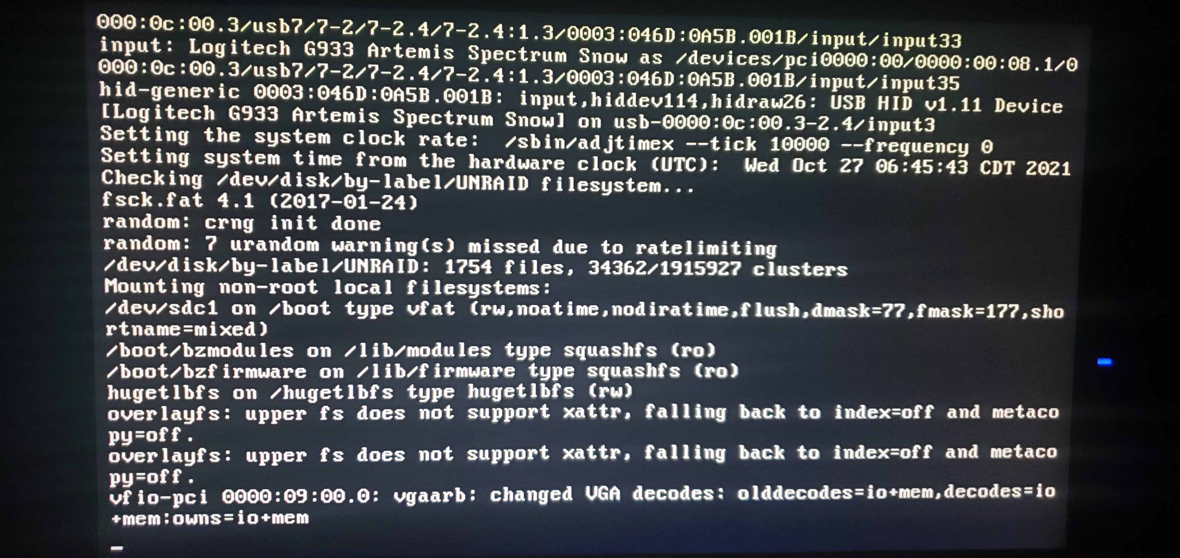

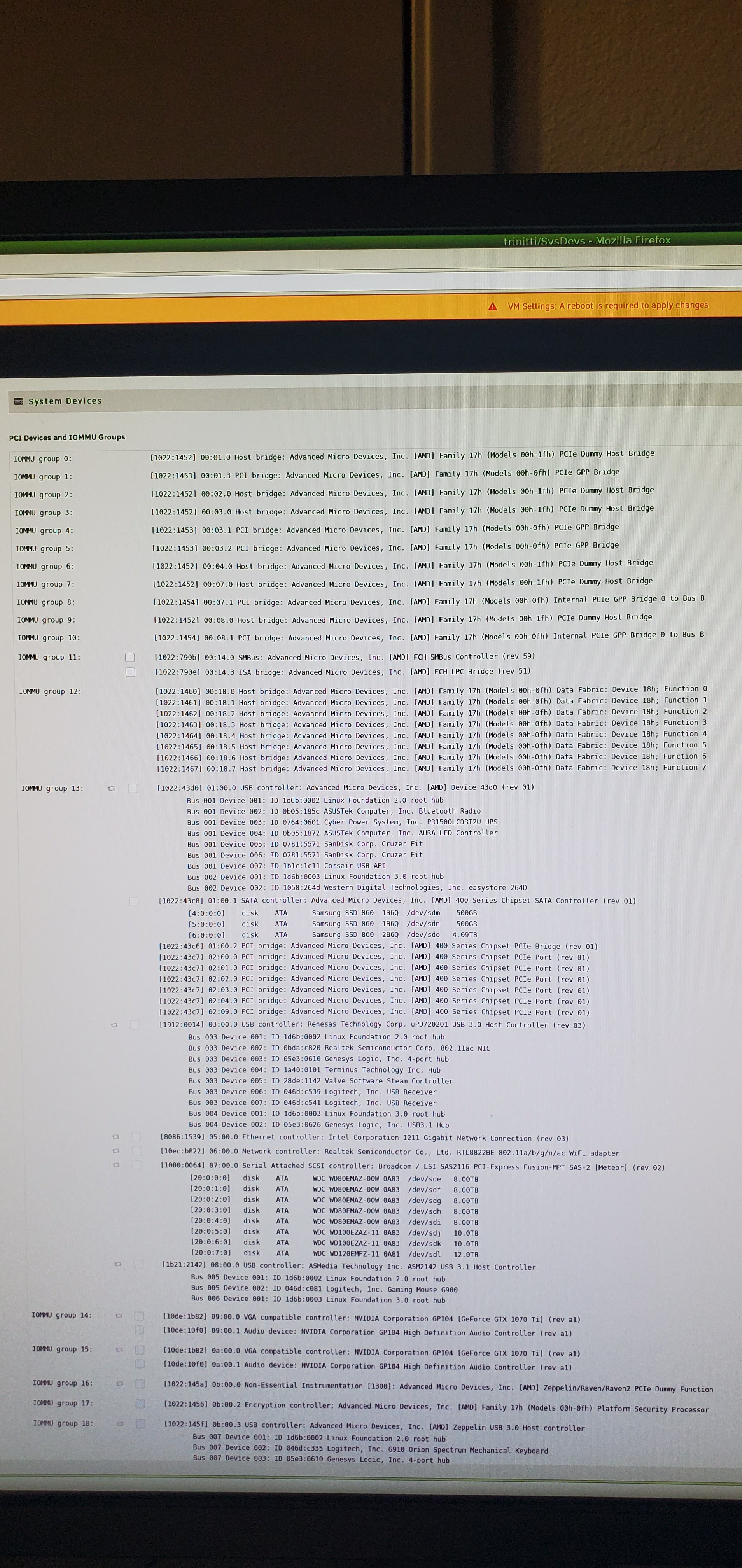

October 27, 20215 yr So I have been working on this problem for hours. I have an Asus Crosshair Hero VII (wifi) with a 2700x and bios #2008. I ran two 1070ti and used 2 windows 10 vms for over 2 years daily (2 gamers 1 cpu) Well I just got a new cpu, 3950x, and I had to update my bios, so I now have 4603. Now both GPU have identical pcie ID names and virtually everything I try ends up crashing unRAID, I have even corrupted my usb a couple times. They are in different IOMMU. I have been able to get ONE of the cards to pass through to a VM, but if I try to start the second one the system hard crashes. I will continue searching for a way to get my daily system up and running, I really hate to have to roll back bios and go back to an 8 core cpu.
October 27, 20215 yr Hard freeze when trying to click the button to pass through the gpus and restart... Have to pull the USB drive again and delete /config/vfio-pci.cfg just to access the server again.
October 27, 20215 yr 28 minutes ago, tsawind said: Hard freeze Hard freeze?It's not...Don't expect to read anything on the monitor after that, because you are attaching to vfio the gpu to which the monitor is connected! In this situation the server is accessible from external devices, via lan. The issue of identical vendor/product ids is a non issue in recent version of unraid because it takes into account both vendor/product id AND physical address bus:slot.function (which is unique) Edited October 27, 20215 yr by ghost82

October 27, 20215 yr 4 hours ago, ghost82 said: Hard freeze?It's not...Don't expect to read anything on the monitor after that, because you are attaching to vfio the gpu to which the monitor is connected! In this situation the server is accessible from external devices, via lan. The issue of identical vendor/product ids is a non issue in recent version of unraid because it takes into account both vendor/product id AND physical address bus:slot.function (which is unique) Correct, hard freeze. I understand that the gpu that unraid is showing up on is supposed to be "handed off" to the VM. unRAID becomes inaccessible from the network as well, so yes a hard freeze.
October 27, 20215 yr 45 minutes ago, tsawind said: so yes a hard freeze and what does the syslog say about the freeze?
October 27, 20215 yr Okay well after a couple of hours of sleep, I have made some progress. I enabled syslog to save to flash, and I believe what has been happening is that when the old VM would start up it was using probably old usb pass-through and other wrong things in the xml. I have the second gpu VM operating, currently working to get a display out of the main (1st slot) gpu. Boom, Success!!! A New VM and using a custom hacked Graphics ROM Bios. ROM file for the GPU, now the "handoff" is working!
