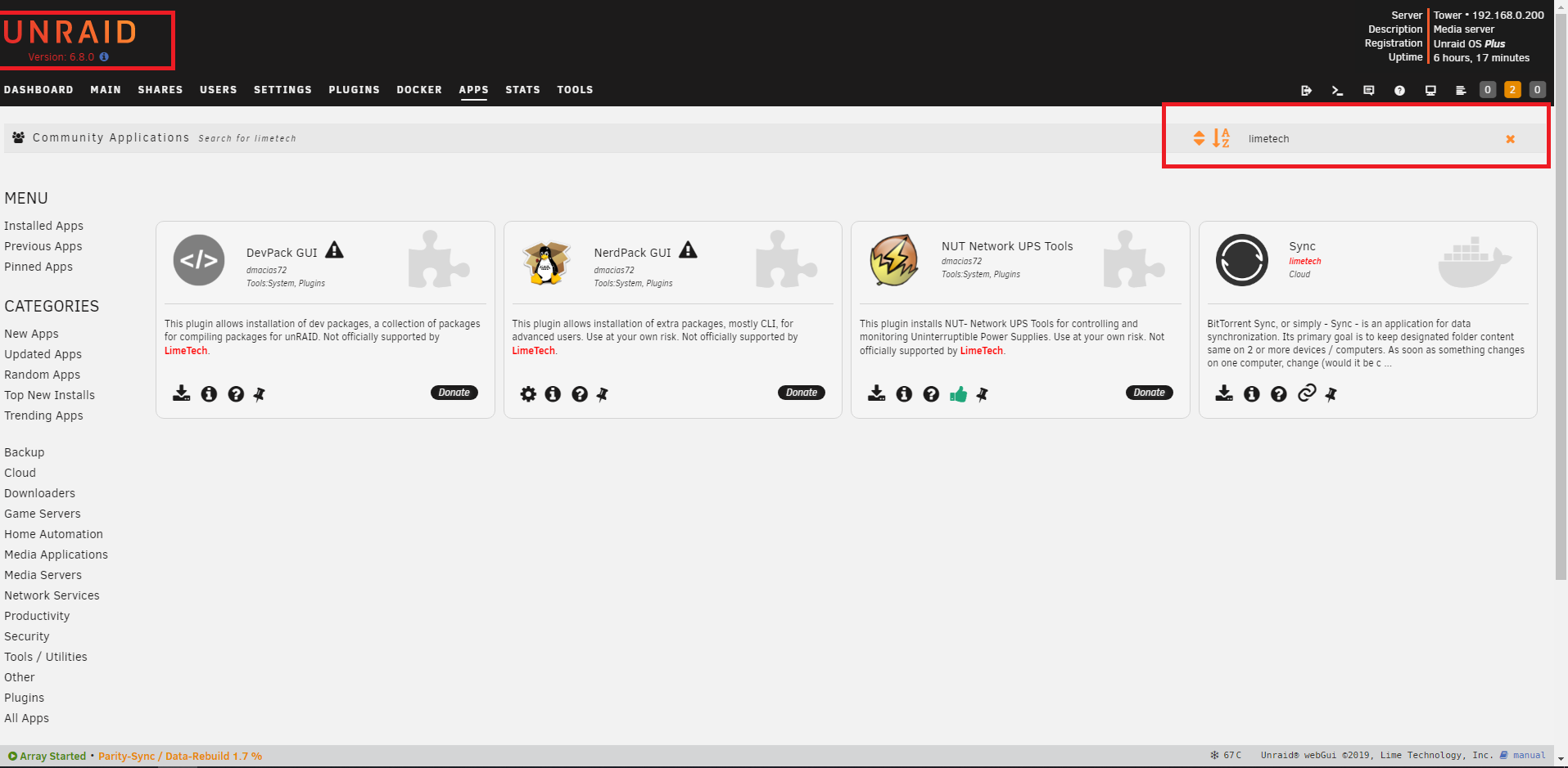

On 2/6/2020 at 11:37 AM, Squid said:
Available within CA.  Either go to the new apps section or search for sysdream or limetech.   If it doesnt appear, then you're not running a version of unraid which the plugin will work on (or isn't needed - 6.8.1 / 6.8.2)
Am I missing something? Not available?
If you read the announcement you will see it states that tHe plugin is not available for the 6.8.0 release. If you are running that release the options are to upgrade to 6.9.1/6.8.2 (which do not need it) or downgrade to a release that is supported.
