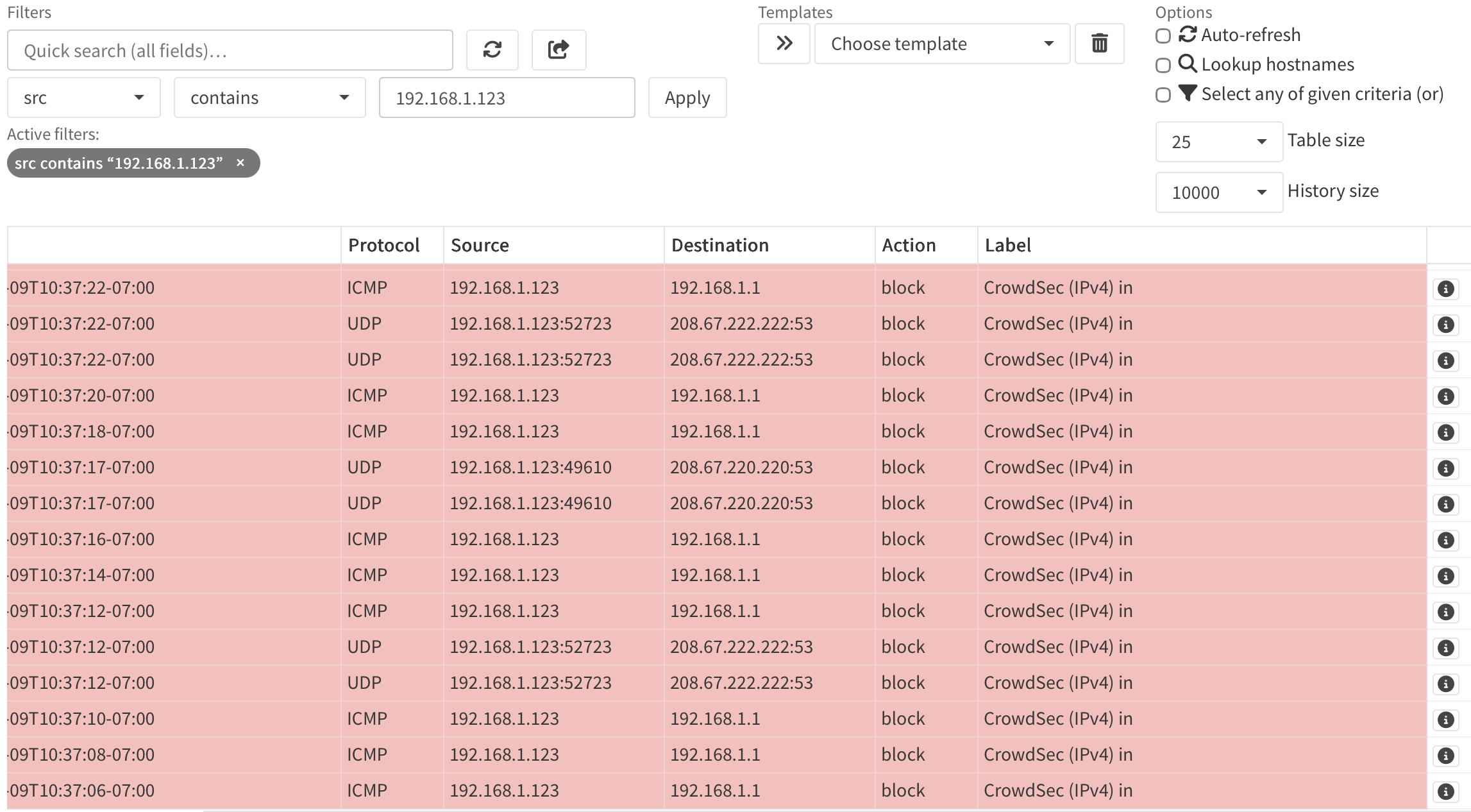

  5. This is wild. Finally looked in my OPNsense logs and can see that Crowdsec was blocking all traffic from my server: Removed that decision, and immediately everything on Unraid started working again. Crowdsec shows it was a decision based on firewallservices/pf-scan-multi_ports from 4 hours ago, which is how long I've been scratching my head over this.
  6. root@Tower:~# cat /etc/resolv.conf # Generated by rc.inet1 nameserver 208.67.222.222 # eth0:v4 nameserver 208.67.220.220 # eth0:v4
  7. Hi all. This morning I noticed that my Plex and all other docker containers were unable to reach the WAN. Also, when I open the Log or Shell windows in Unraid's UI I get just a blank window, and Community Apps says it can't reach anything. I have changed my server's network DNS config from Automatic, to OpenDNS's IPs but it didn't help. If I try to ping or nslookup from an ssh session I get no response: root@Tower:~# ping google.com ^C root@Tower:~# nslookup google.com ;; communications error to 208.67.222.222#53: timed out ;; communications error to 208.67.222.222#53: timed out ;; communications error to 208.67.222.222#53: timed out ;; communications error to 208.67.220.220#53: timed out ;; no servers could be reached All other devices on my network are functioning. I don't really understand what the issue could be. Diagnostics attached. Thanks! tower-diagnostics-20260409-0933.zip
