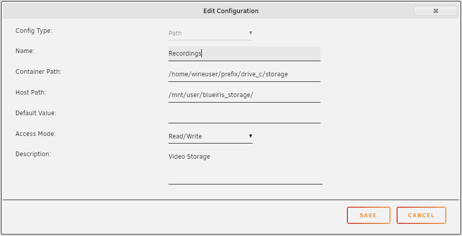

It appears its writing to my docker image? I changed to unassigned ssd but do not show where videos are being written to. Any ideas?

okay got mine working i could not use an appdata folder like we usually do. I used a docker volume to create persistant data. I have my system up and running. i am using leonowski/docker-blueiris. I mapped paths to docker home folder and pointed blueiris to those so i dont store video in the container. working on getting webui set up but so far liking it more than shinobi.

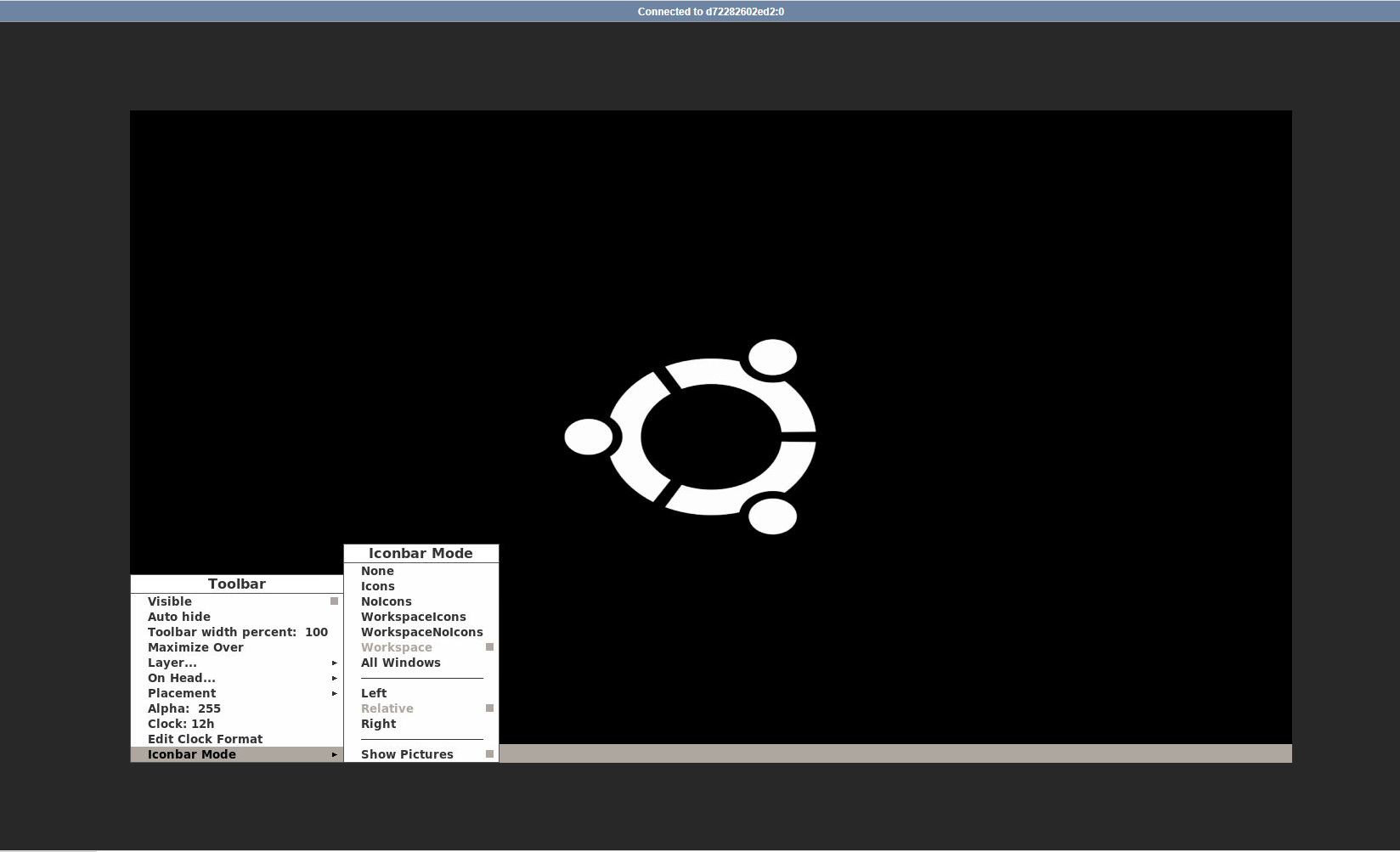

Whilst doing this troubleshooting and removing/reinstalling I've now got into a state where I can't run it at all.. Well, running it then going to the GUI (or /vnc.html) shows the attached desktop, which I'm assuming is a WINE desktop.
If I remove Blueiris and select to delete the image, then try to download again, I am seeing that some image IDs already exist (may be the cause of my WINE desktop issue).  Is there some files somewhere I need to manually remove?
Thanks for any help for this unraid noob who is still learning as he goes :)  I am looking forward to using BlueIris in docker and utilising the VM for something else.

I see an update for this docker. So I applied it.   BlueIris is now launching again.. However, date/time is still incorrect and doesn't match date/time in WINE.
Running fine for me with the exception of the time being in UTC no matter what I try. Interestingly the /etc/timezone file is set for UTC, so I thought that would be the trick, but the system itself thinks it has the correct time anyway so changing that to my TZ did nothing. Resolution can be sorted by editing the 'screen' section of /etc/X11/xorg.conf.

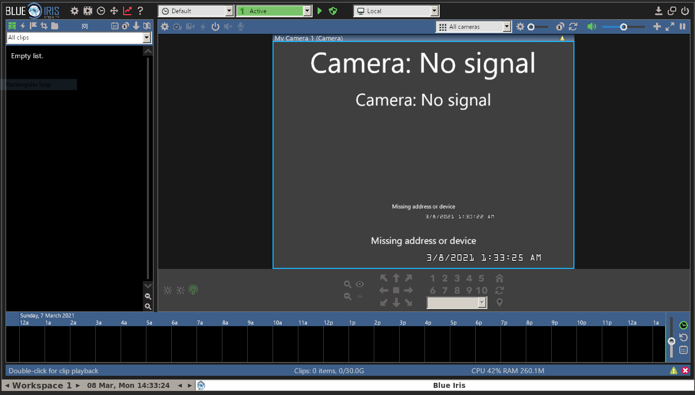

I cannot seen to get a camera configured in the demo version. Is that possible?

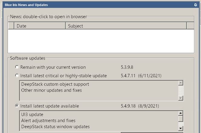

Hello. I've been having problems with this freezing/not responding and it does not appear that updating the app (BlueIris) works. Can this be resolved. So happy BI is in a docker! Thank you!

Would be nice to move BI into unraid and decommission the extra PC, but I don't see a lot of talk in here.  Also, can the latest BI.exe be moved in to keep it updated?
