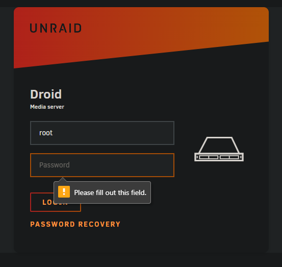

Tried that, It still tells me the PW is required
Edited by Cramoly
yeah, i told you it is required. But if you have followed the instructions "how to reset the root password" it will be EMPTY and only the ENTER key is needed then.

Yeah, I only pressed the enter key with it blank, and that's still the result I got.
