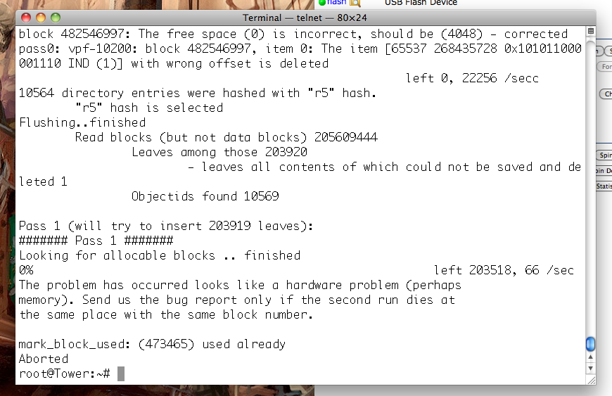

I'm at a dead end. One of my drives, I still don't know why, experienced some fs corruption.
I tried to launch reiserfsck --fix-fixable which fixed some of the errors but not all. It asked me then to run the procedure with --rebuild-tree option. Unfortunately the procedure stopped soon after passing Pass 0 phase indicating as a possible problem memory. I ran memtest but the report doesn't show any errors and so does the syslog. I even tried to mount a swap file as indicated in another thread but without success. Any time I run the test it always stops there (please check the screenshot).
At the current status the drive, since reiserfsck hasn't completed its process, shows up in the web console as unformatted. Can someone give me any advice on how to recover this drive before starting thinking I lost everything on it?

Disable any add-ons and stop the array to free up memory and try to run with rebuild-tree again. Are you running it on /dev/md3?

I ran reiserfschk --rebuild-tree as suggested by dgaschk and, for the first time, it went through all the process - I suppose because the disk is containing 1/10 of what it contained before. A lost+found folder with a bunch of files inside it was created. I reassigned the disk to the array and started it again. Now it seems I'm not getting any strange errors anymore.
