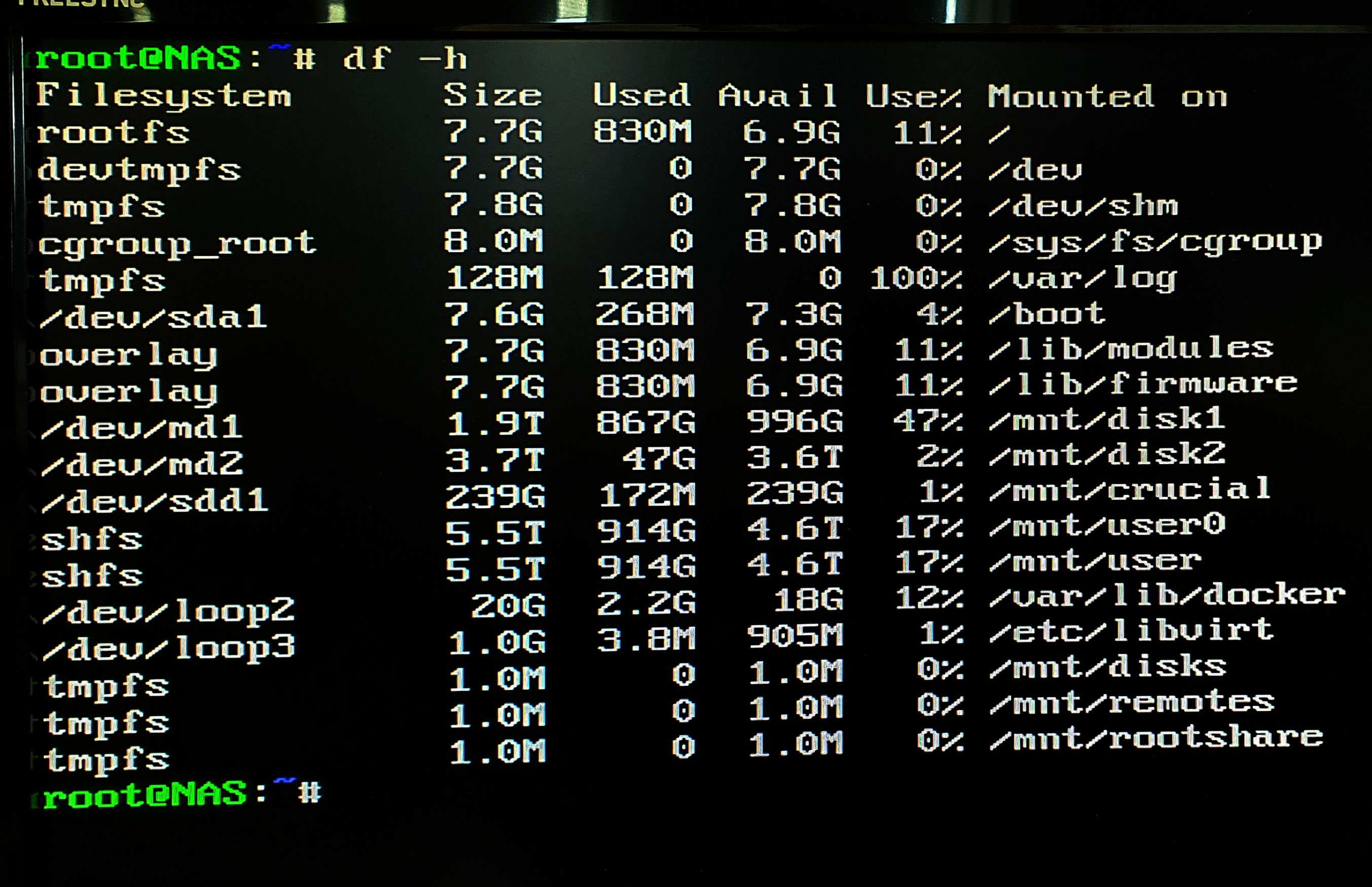

What do you get from command line with this?
df -h
Here is what df -h reports. Do i see this correct in that my 8GB usb drive is not full? Is it possible that the logfile is too big in the first place to get written to the stick?
Had to force reboot via reset button. On first reboot i did get diagnostics, which are attached. I did not see my two HDDs but both SSDs. I shut the PC down properly and plugged the sata cables of both HDDs into different ports. Now all drives can be seen but Parity is still disabled. I am now running an extended smart self-test on the paritry drive.
