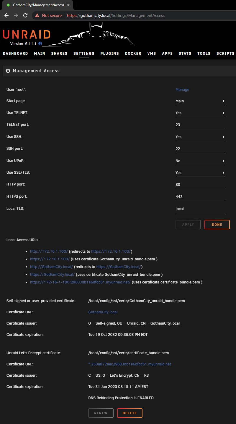

November 2, 20224 yr Hiya! I provisioned a certificate then enabled https and https redirect. Using all available links on the management access page I get 'Not secure'. Here is my config: Thoughts?
November 3, 20224 yr Looking at the "Local Access URLs", the ones that say "uses GothamCity_unraid_bundle.pem" will not be fully secure as that is a self-signed certificate. The one that says "uses certificate_bundle.pem" is going to be fully secure. However, the screen also shows that "DNS Rebinding Protection is ENABLED", so you won't be able to use that cert until you disable DNS Rebinding Protection on your network. It might be as simple as changing your DNS provider to 8.8.8.8, or you might need to Google "[your router name] disable dns rebinding protection"
